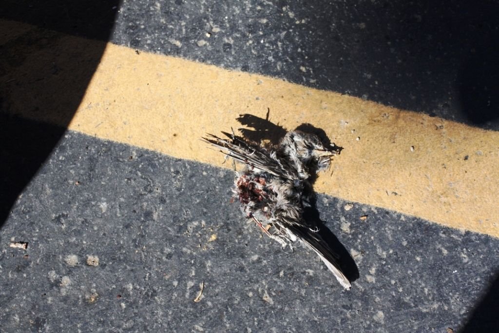

I just came back from a coast to coast trip and the intercooler is full of bugs. I even pulled a freaking bird out of it!!
Anyways, is there anything I can use to clean this thing? Take it off and hot tank it? any chemicals?
I was thinking either hot tank the thing or use that foam spray used to clean AC coils.
Some pics:
Thanks, J
