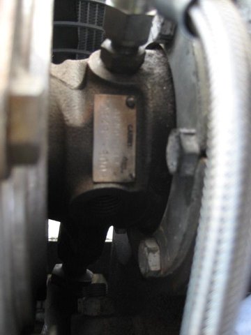

i have precision on one side and garret written on the other

100% of Precision turbos use Garrett's CHRA's (this includes the bearings, wheels and everything) . The only thing Precision manufactures are the housings. And there pretty much just replicas of the Garrett housings in most cases. As far as journal and bushing bearing turbo's go, the housings are going to be almost identical to Garrett's. When it comes to GT series housings, Garrett's are going to be a bit better flowing but its probably not going to be that noticeable of a comparison.
They both have the same re-build ability as they both share the same CHRA.
