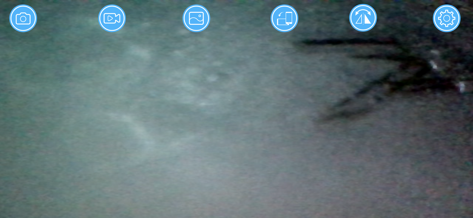

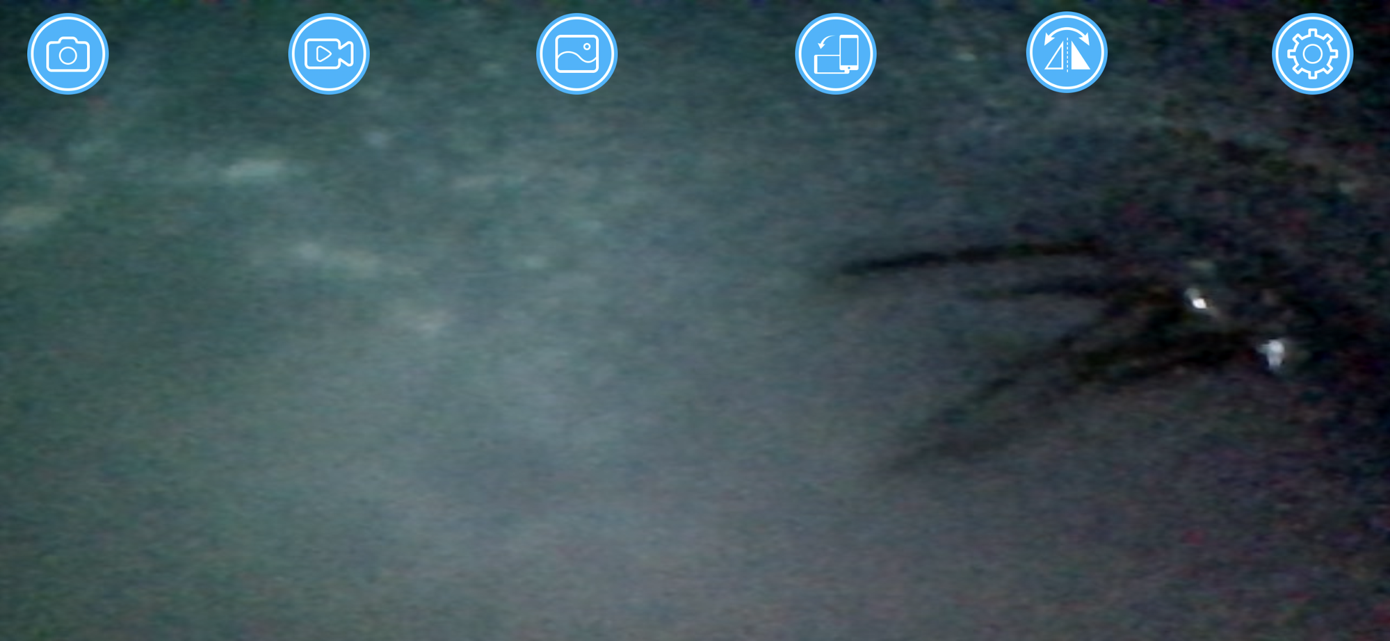

here a picture of piston
and valve video..
https://streamable.com/flkknm?src=player-page-share
i tchecker
clearance and they are good
