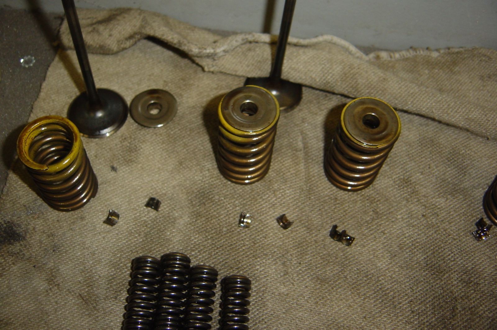

- Supertech valves, dual springs and seat locators

4. Are the Supertech intake valves oversized? And what is the use of oversizing?
5. are the Supertech exhaust valves nitrite coated? And why?
6. Will 10k rpm be safe with this setup @ 23psi ?

u can get the valves in over size or stock size, i would just go with the inline pro 3mm head gasket instead of the cometic 2mm, the valves are coated, and yes i think the cp pistons with pauter rods would be ur best combo, def give laskey racoing a call, but if ur gonna do pistons thats gonna lower the compression instead of the hg, what kind of head gasket are you guys running with built engines?

As for the head, with dual springs and ti retainers you should be able to handle 10k but your cams won't let you make any power there anyway. I did mine just as a precaution just in case I overrev or whatever with the added power.
