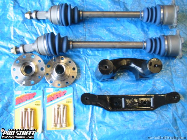

Originally Posted by bobmoheb,May 13 2005, 09:35 PM
So you are saying that with this kit I will be able to drop from whatever RPM I would like and I will be completly ok.
you will just transfer the weak link to the gearbox, clutch and propshaft
this kit will only prevent failure in the diff, cv and axles
for serious competition you will need to upgrade the gearbox and clutch as well
for those interest in using a 240sx diff, which is lighter and smaller than the R33, you can check these links for more information
http://honda-tech.com/zerothread?id=1216799&page=1
https://www.s2ki.com/forums/index.ph...&f=22&t=287471
kandamotorsport has also produced axles and cv rated way above 1000rwhp, if our 4 cylinders ever get there . The outer cv has speed sensor teeth on the outer cv too so there is absolutely no modification necessary. Check my links for the shopping list.

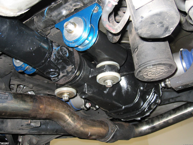

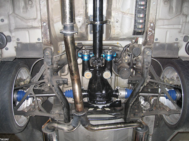

Hey Guys,
here is the finished product, I have tested it and it works great. Also I will be racing the car on Wednesday, I will post a vid of how the car performs down the quarter.
Sorry about the size of the pic, but you can get a better look of everthing fitted.
Cheers
