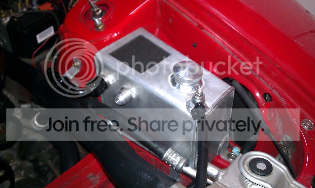

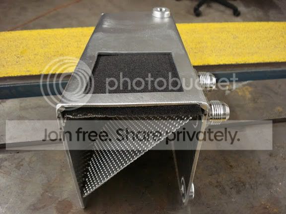

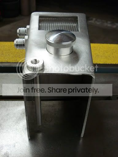

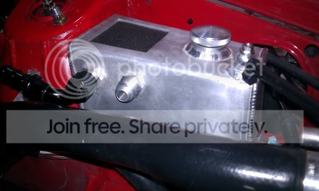

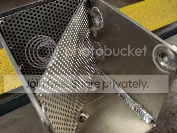

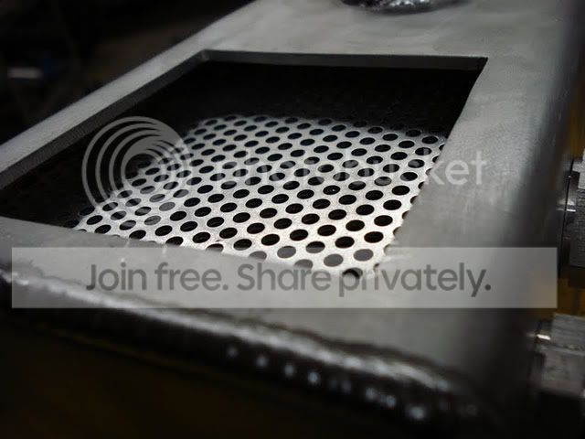

Figured I'd Post this here, its the latest design me and my partner have come up with, Its a dual purpose combo can that WORKS! It is the only internally baffled and filter can out there.Its a radiator overflow and catch can in one, the internal oil baffle helps trap oil vapor which keeps the oil in the can, but will still breathe to the atmosphere using the internal filter element (it can be removed and cleaned) and the coolant overflow functions just like stock allowing for coolant expansion when hot, and vaccumm to pull the coolant back into the cooling system while cooling down......Let me know what you guys think!

^ pm me a price i like that

Irishflame - Can you make anymore of those?
