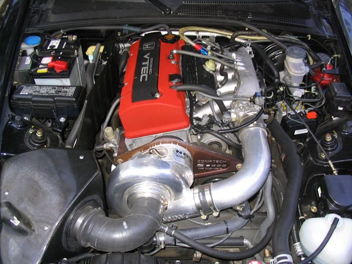

before I start. I have a MY 01' S2000. Here we go:
So i've been driving my S for a couple of weeks now. Getting to know it, trying to find any bugs. The S was supercharged at Comptech in california. (it was shipped there, installed, and shipped back). So its a clean install.
Everything has been fine, until here recently. I noticed while driving, if I push the gas down a certain amount at low rpm (3-4k), the engine bogs really bad. Even at the top end. If I drop it into 3rd and punch it, the car accelerates, then bogs and slowly starts to pick up.
Also, if I take off from a light normal driving, shift into second and give it some gas....BOG. I read about the map sensor needing a whack, or replacement with the TSB that came out, but I was wondering if it could be something different. The TSB states that there is hesitation up top, but mine does it all over the place, depending on throttle position and rpm.
On a different part of the car I noticed this.
When i'm at a standstill like at a light, sometimes when I put it into first gear the car jerks forward slightly as if the clutch wasnt engaged all the way, but I ALWAYS push the clutch in all the way. Also, sometimes when I go to pull the car out of gear while moving, it doesnt want to come out of gear without a bit of fight. Sometimes if I let the rpms drop a little it will slide right out of gear. Clutch issue? Tranny issue? Thanks for any input!

Flush and bleed you clutch fluid. Sounds to me like your clutch is dragging badly.
Check your spark plugs, both condition and gap. The gap in a F.I. car needs to be much smaller but the consequence of this is that they can tend to foul more quickly.
Also double check all the wiring with the ESM. If they aren't soldered, do it.
ps. We have a F.I. forum for this sort of topic. Moving there now.

It's good that you have this documentation. Previous to about a year and a half ago, most Comptech installations, regardless of where it was done or who did it, were done with crimp connectors. These connectors can fail in a week or a month or a year or never. Comptech has since advised all installations to be done NOT using the provided crimp connectors but rather, soldered connections. A Comptech "authorized" Honda dealer installation does not necessarily mean it was done correctly as many owners have painfully discovered. I'm not saying there is something wrong with your installation. I'm just saying it is but one other place to look.

I would change your Manifold Absolute Pressure sensor immediately. If there is a TSB out for it then change it no matter what it bogs out at. MAP sensor does play a factor into your car bogging or not. You might want to check your throttle positioning sensor as well to for good measure.

With few exceptions (2 bad coil packs) every "poor performance" issue I've had has been the MAP sensor. I'm on #3, not that bad for 143k.
I've had bad idle, bad off-idle, mis-fire at mid-range, hesitation and bucking when accellerating, etc. For the price of a MAP sensor just buy one and put it in. Worst case, if it doesn't fix it you'll have a spare MAP for when it DOES eventually go bad.
