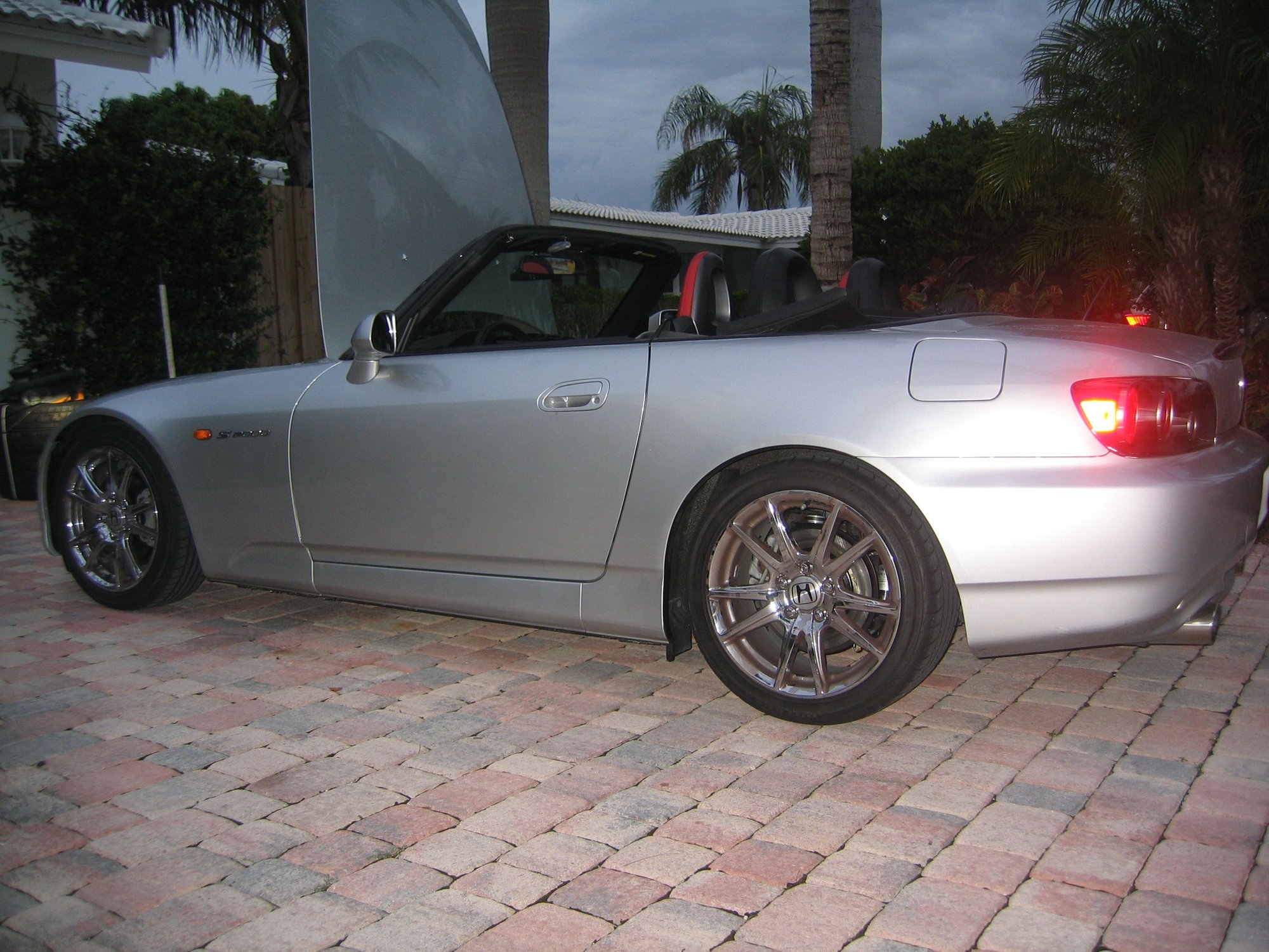

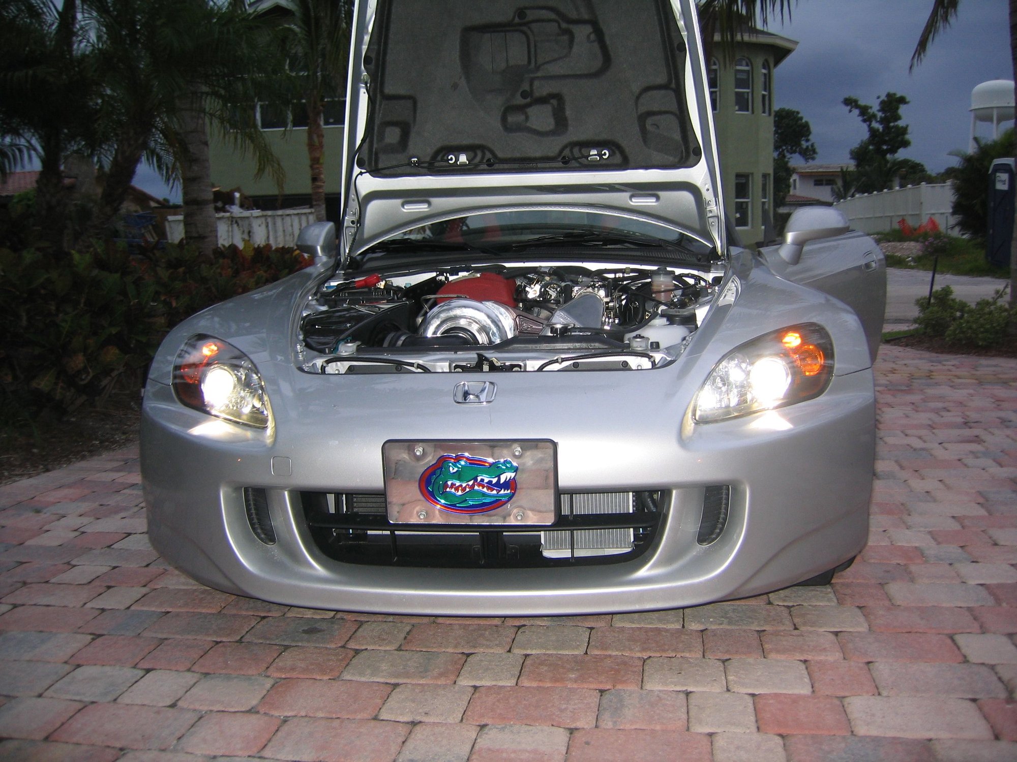

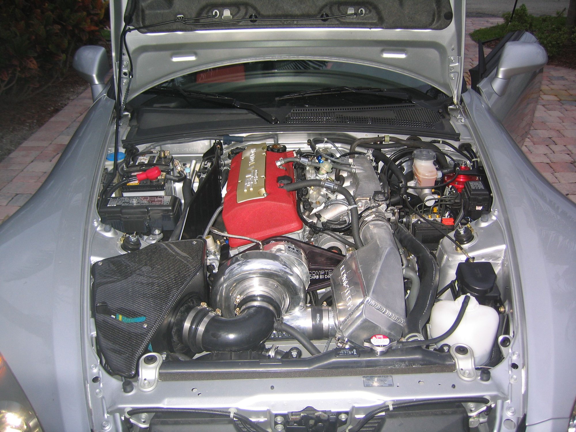

Put the car up on jackstands beginning of June, and just took the car for the first drive tonight. That shift beeper I'd put in for the track is a godsend with this - 60 mph comes up damned fast.
Just wanted to say thanks to the forum - from the directions on clutch install to the warnings about the SC noise (jet engine + rocks in a can - if I'd not known what to expect I would have had a heart attack). This forum is invaluable. Now I just need to sort out the brakes a bit - went to stock pads and don't feel like they grab compared to my cobalt GT-Sports (changed to reduce dust). No CELs, no leaks, and looks like I put all the bolts back on because nothing fell off . I enjoy doing the work myself, but this one kinda grew - but I'm definitely happy with the result. Mods I just completed:
*New ACT PP, Competch flywheel and stock clutch disk (hardtop guy package)
*New Comptech SC + AC
*KW V3 Coilovers
*Comptech front anti-sway bar
*CE28N Mercury Silver + Advan Neovas (rims come in next week)
I'll get the car dynoed and corner weighted in a couple of weeks after it settles on the springs a bit. The Comptech kit goes together great - really surprised at the quality/how easy it went. A few pics:
