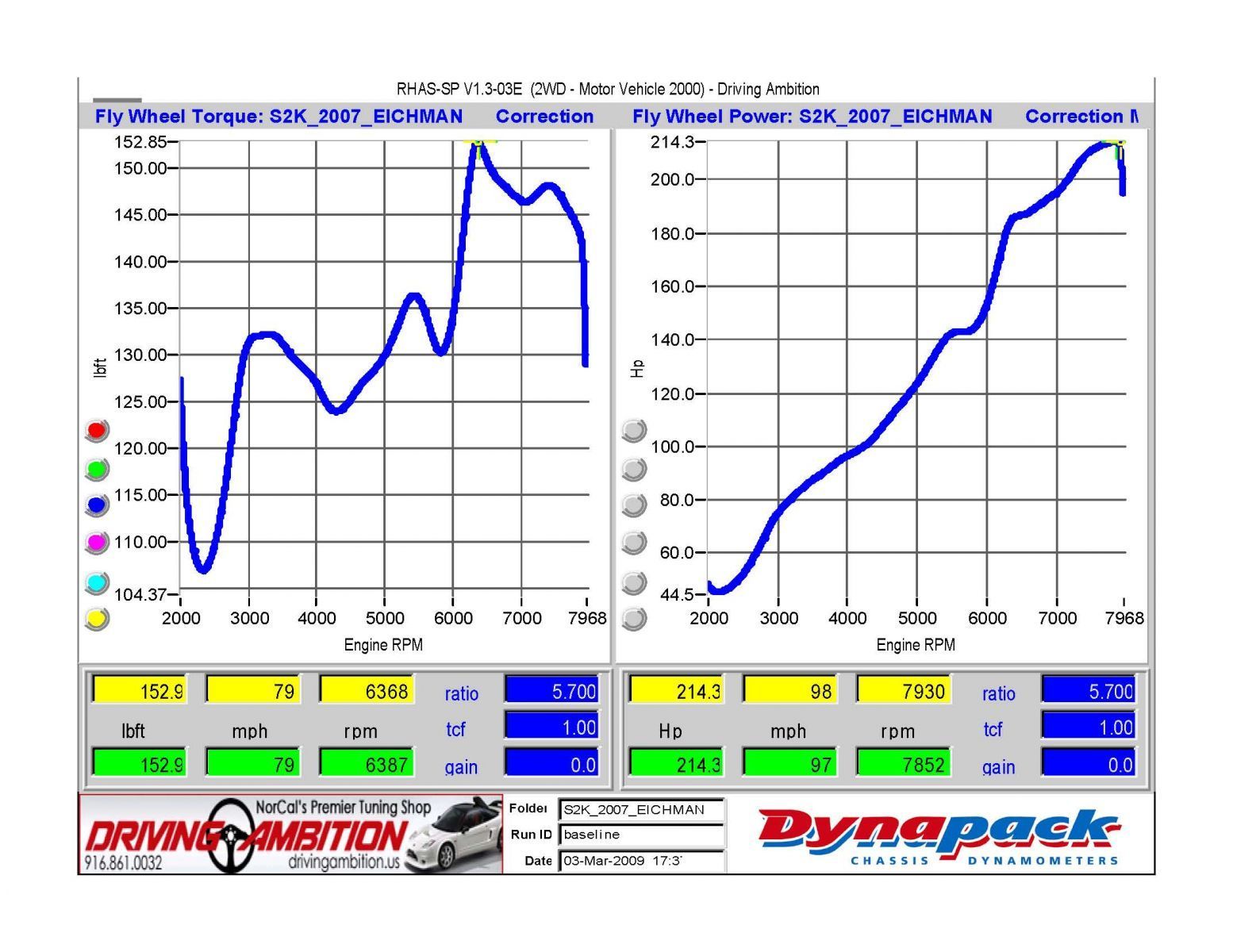

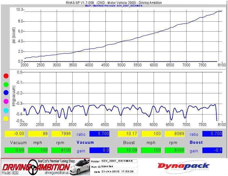

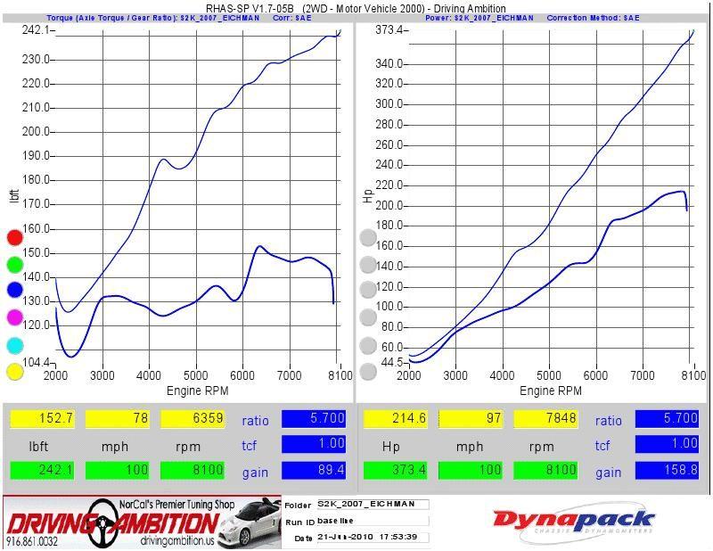

Just getting my car back this weekend. Here are it's Dyno numbers...373rwhp/242lbft tq @ 10psi.
It's an '07 S2K with the new CT Engineering SC (Novi 1220SL), Comptech header, 550cc injectors, T1R 70mm Stainless Exhaust (Catalytic Converter still installed as I'm in in CA), 91 octane gas, and tuned with Hondata FlashPro.
Installation and Tuning By Driving Ambition. Thanks Shad!!!
Stock Dyno (w/ Comptech header only):
After SC/Exhaust/Hondata FlashPro Install & Tuning:

That is awesome. Congrats!

My 550cc injectors are right at their limits @ 10psi according to Shad.
