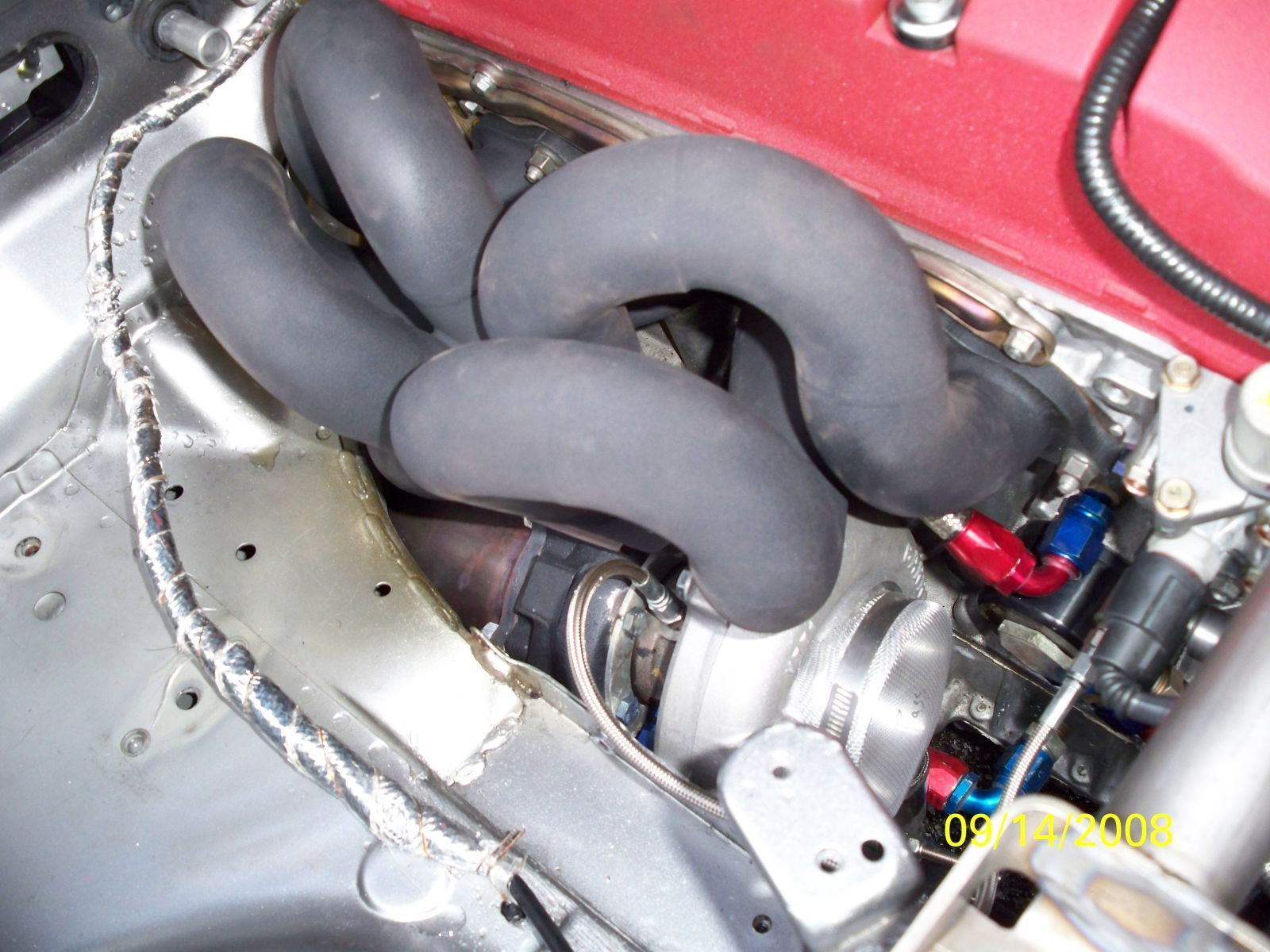

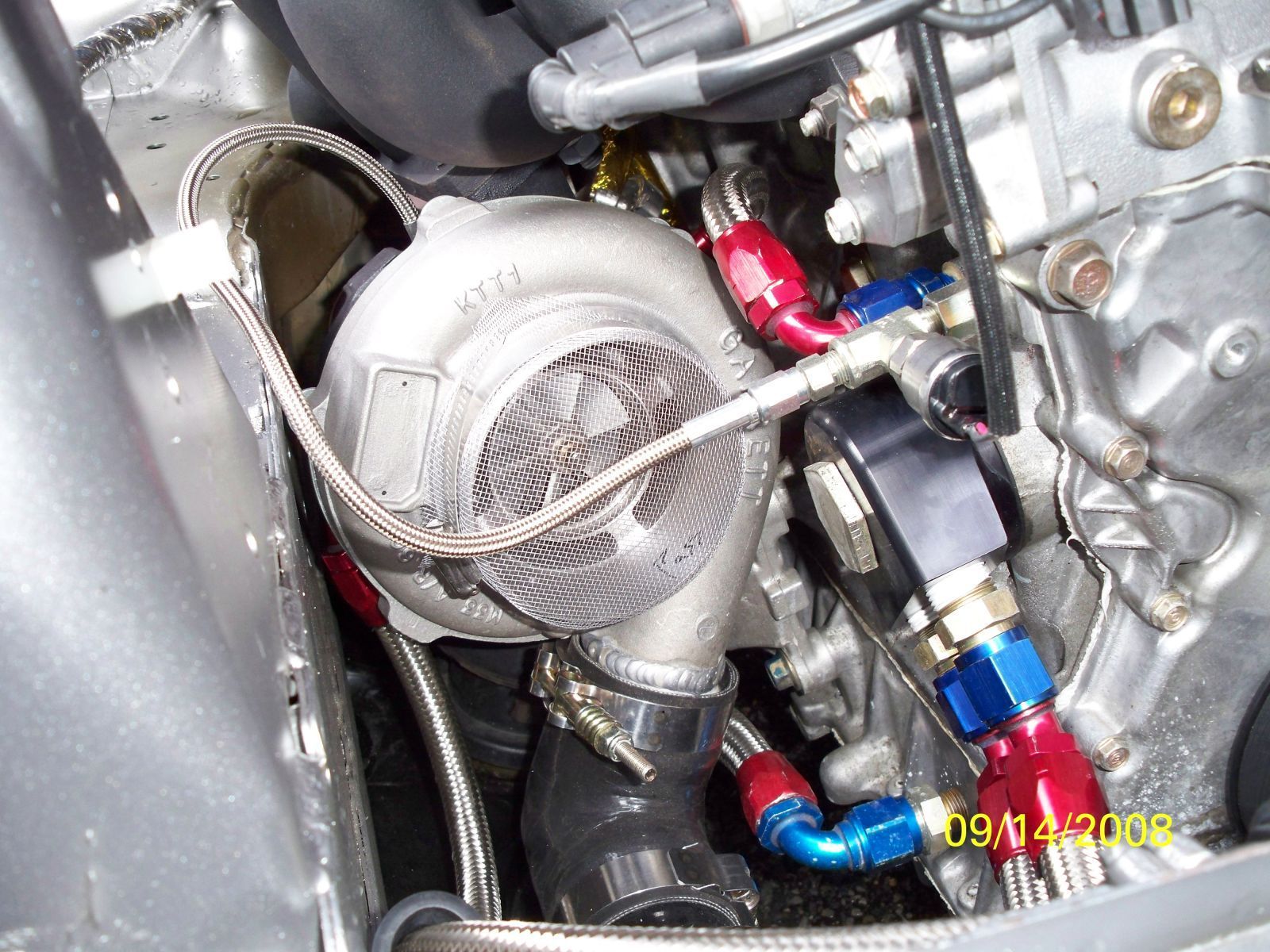

Old May 23, 2009 | 04:25 AM
jwa4378's Avatar
Joined: May 2005
Posts: 4,331
From: Tallahassee, FL
John
Old May 23, 2009 | 10:46 AM
passmans2kny's Avatar
Joined: Dec 2005
Posts: 5,651
From: huntington long island
Old May 23, 2009 | 01:16 PM
