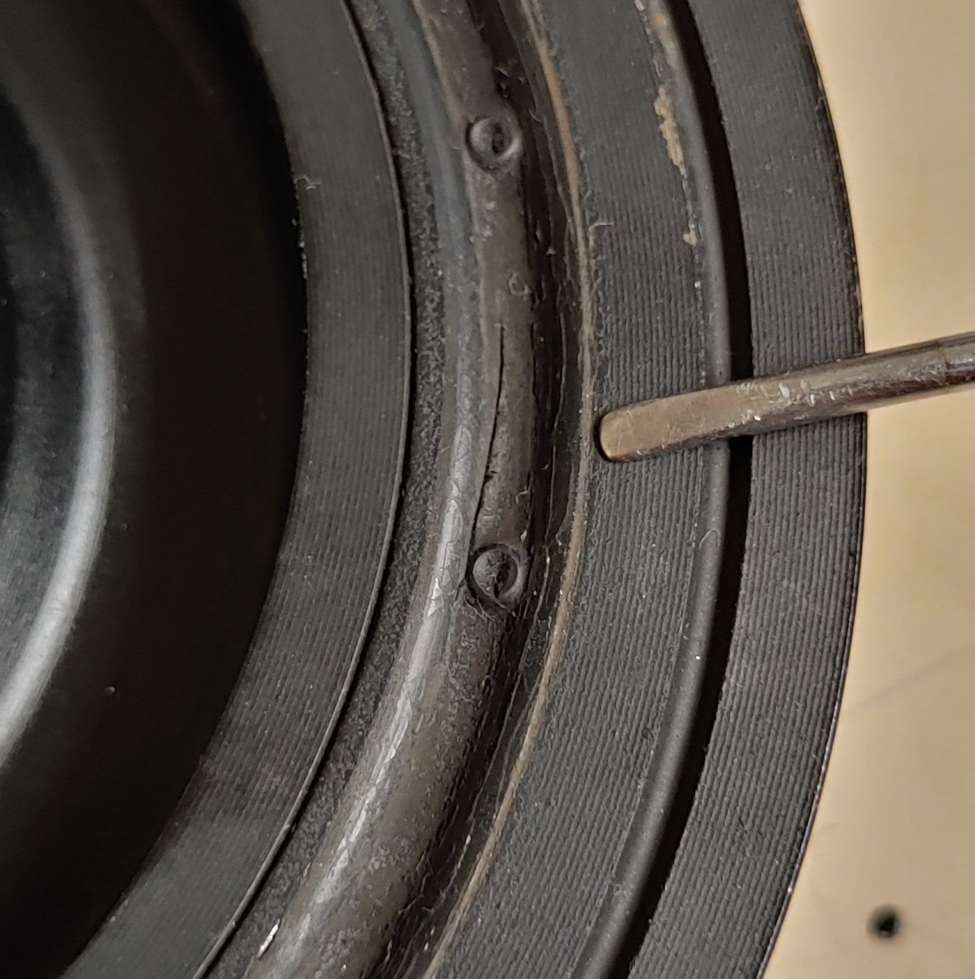

Just had a closer inspection on the crank pulley that was previously used on a Comptech SC kit.
Not certain on mileage on this but it was used in track competition so lots of hard use for sure.
Is this normal and no problem to use?
Guess safest bet is to just drill and tap a new pulley but wanted to check with you guys first if it's unnecessary.
Front side there is only this tear
Back side, there are seven cracks or tears. The smaller ones is might be hard to spot in the picture.
These are the two bigger ones.

I wouldn't chance it; you definitely do not want that rubber isolator failing and allowing the outer ring to separate, especially with a supercharger pulley bolted to it. New OEM crank pulleys aren't too expensive iirc, I'd just start with a fresh one. Age plays just as important as a factor as mileage on these things. I'd imagine over time that rubber will eventually start to dry out and crack depending on conditions. Even though my original pulley was in good shape I still had TTS machine me a brand new one for my supercharger kit; not something I'd want to have to do twice if I can help it.

agree on not chancing it. If there are visible cracks in the isolator it will only get worse

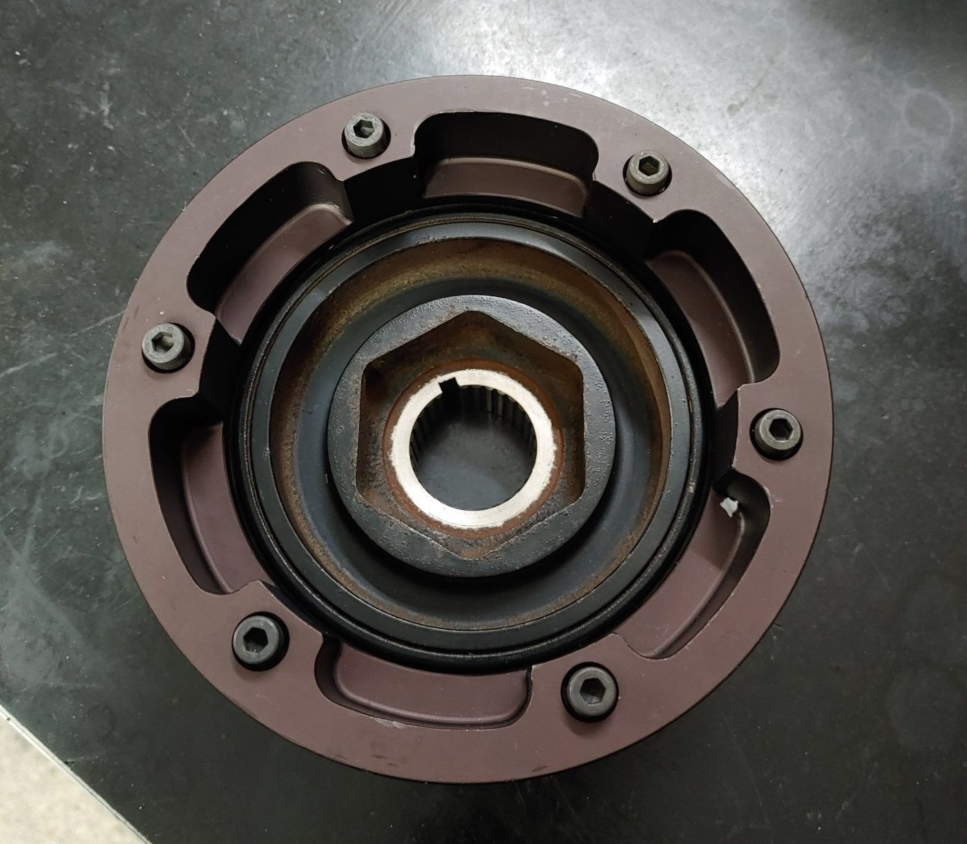

Managed to drill and tap my existing pulley, wasn't much room for error here.
But everything lined up great.
I used new M5 12.9 hardware instead of the previous 10/32 x 1.25" bolts provided by Comptech.
Just need to get a bottoming tap so I can get max thread engagement, maybe touch up that rust as well.

I guess it's possible but not sure if it's needed or even advisable?
There is plenty of thread engagement and the threaded hole is already slightly poking through the bottom of the belt groves.
The other pulley looks the same so I did not mess up the drilling, I will try and clean it up some though, don't want to risk damaging the belt.
I borrowed a nice bottom tap from a friend and done all the holes, picture is right after tapping so it might look worse than it is.
