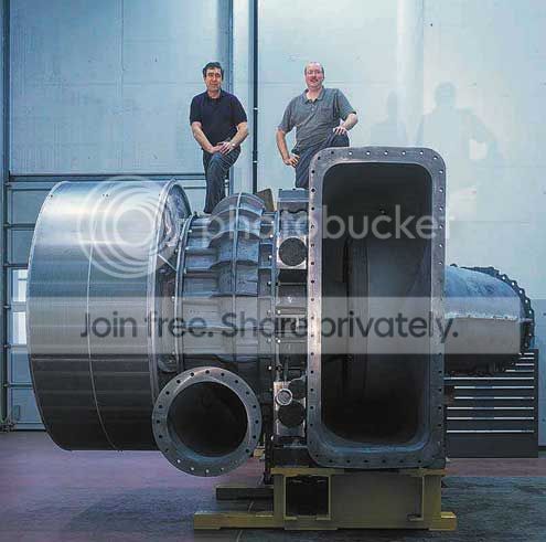

dam 10000cc injectors, this thing must be beast
Old May 10, 2011 | 10:22 AM
DFWs2k's Avatar
Joined: Oct 2005
Posts: 14,614
From: Denton, TX
must be using one of these
