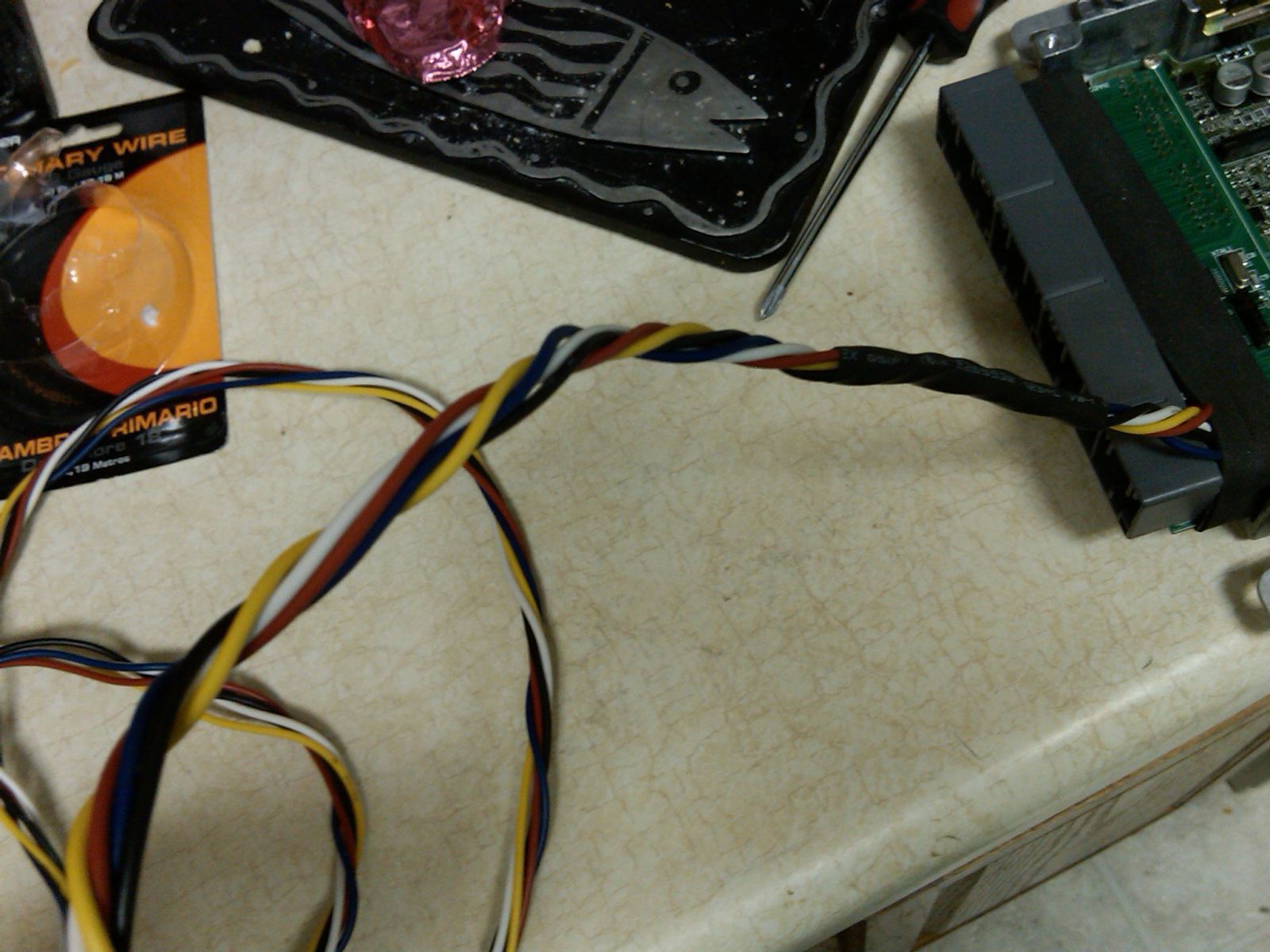

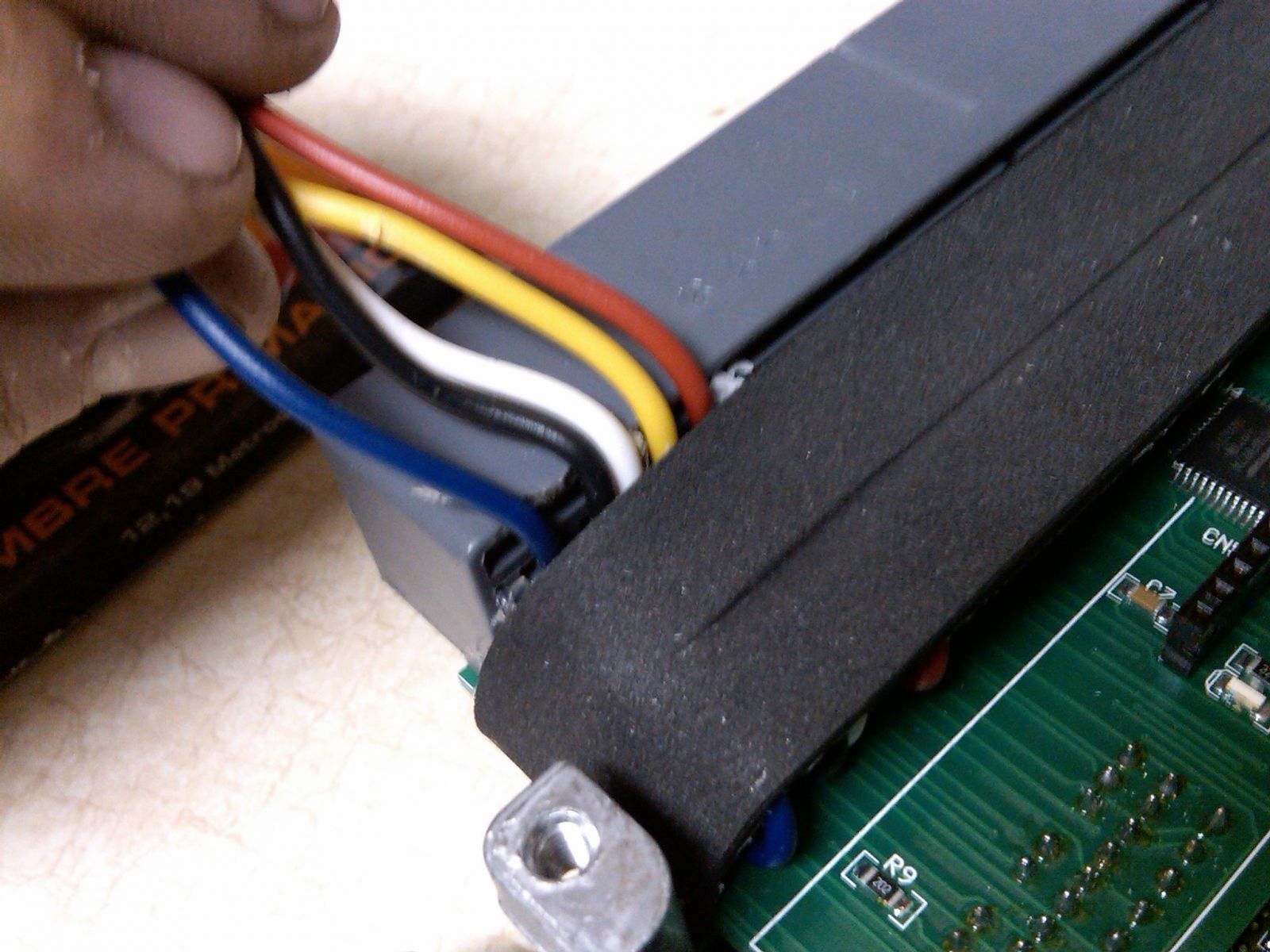

I have been checking into a way to make the wideband O2 sensor from the RSX Type S work with the S2K version of Kpro. With most of the credit for the research of where to attach to the board and how to go about wiring it in I have slighly improved on JustinCs procedure and done the conversion myself.
Here are some pics.
I'll post up more and in more detail once I finish but this seems to be a major improvement over the method JustinC used where the whole daughterboard had to be de-soldered.
here is a link to the thread with JustinCs info...
https://www.s2ki.com/forums/index.php?showt...0401&st=100&hl=
