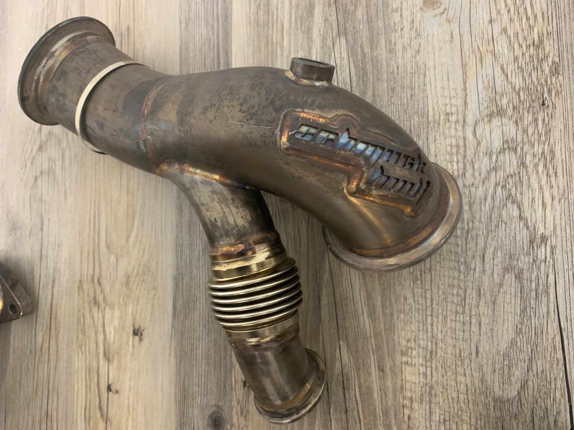

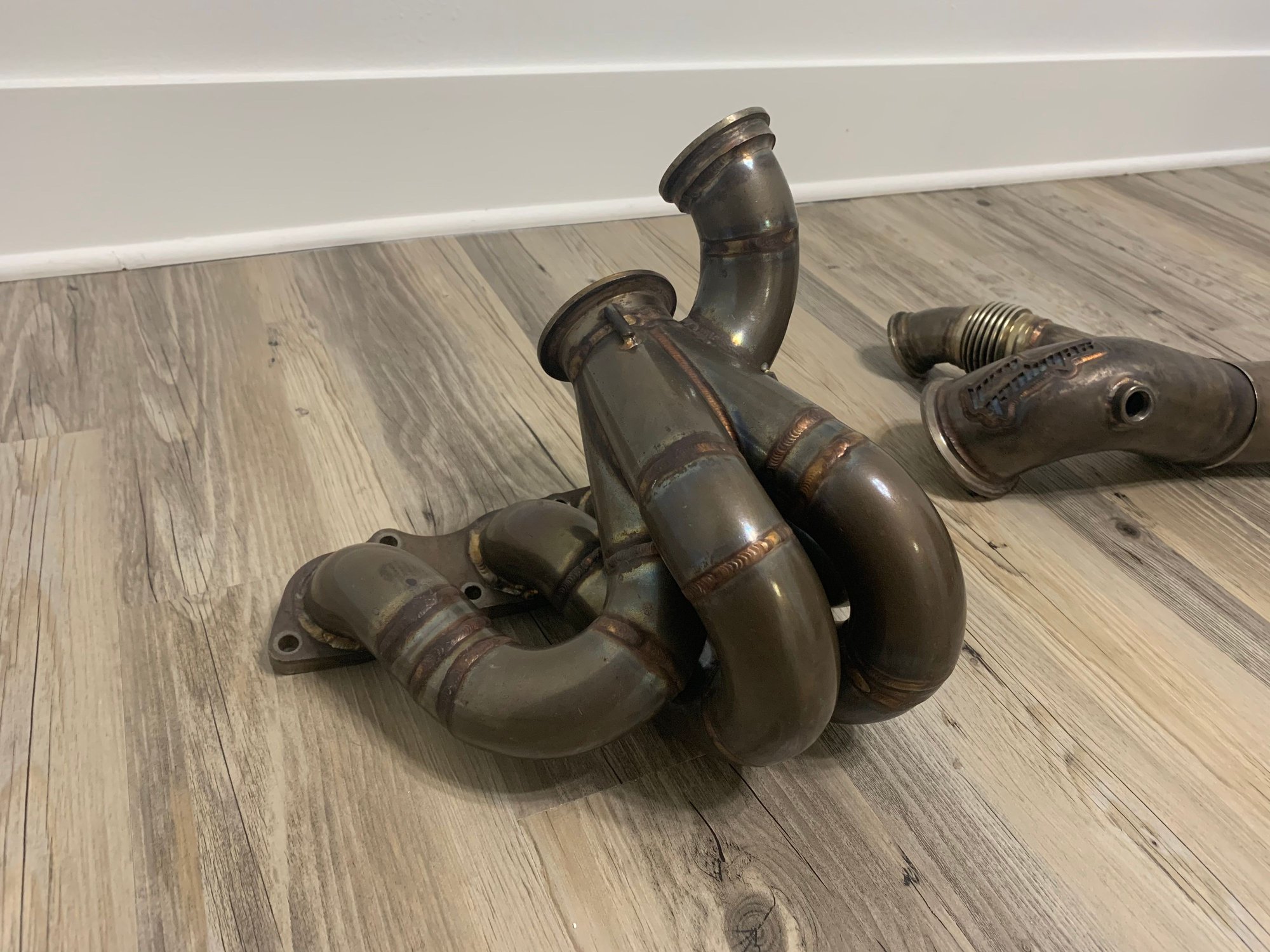

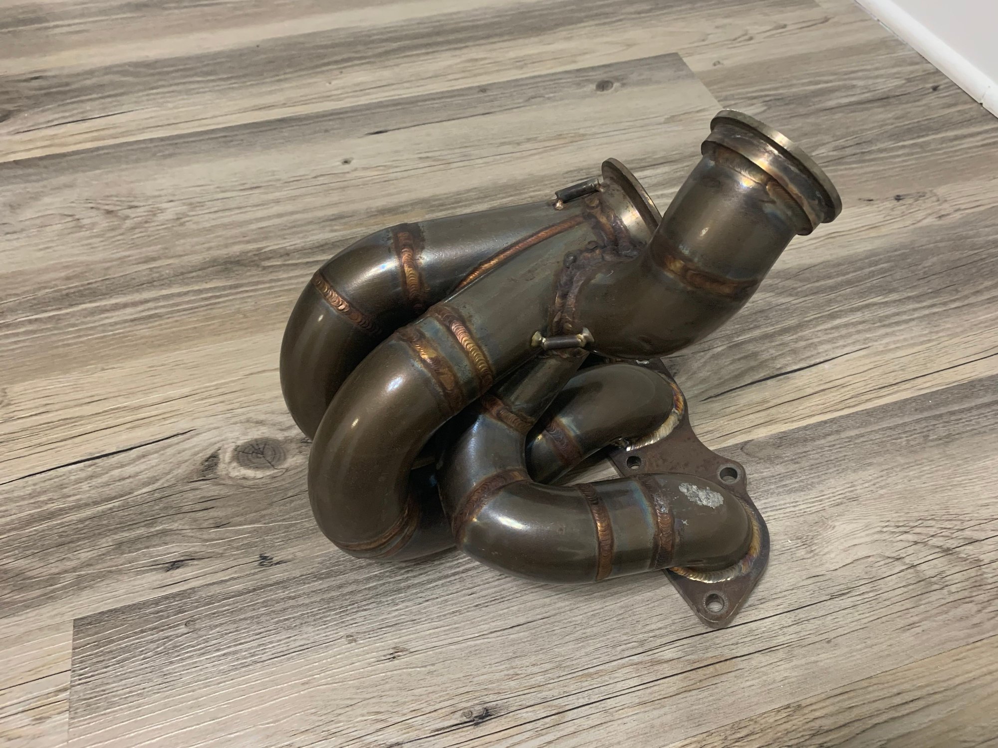

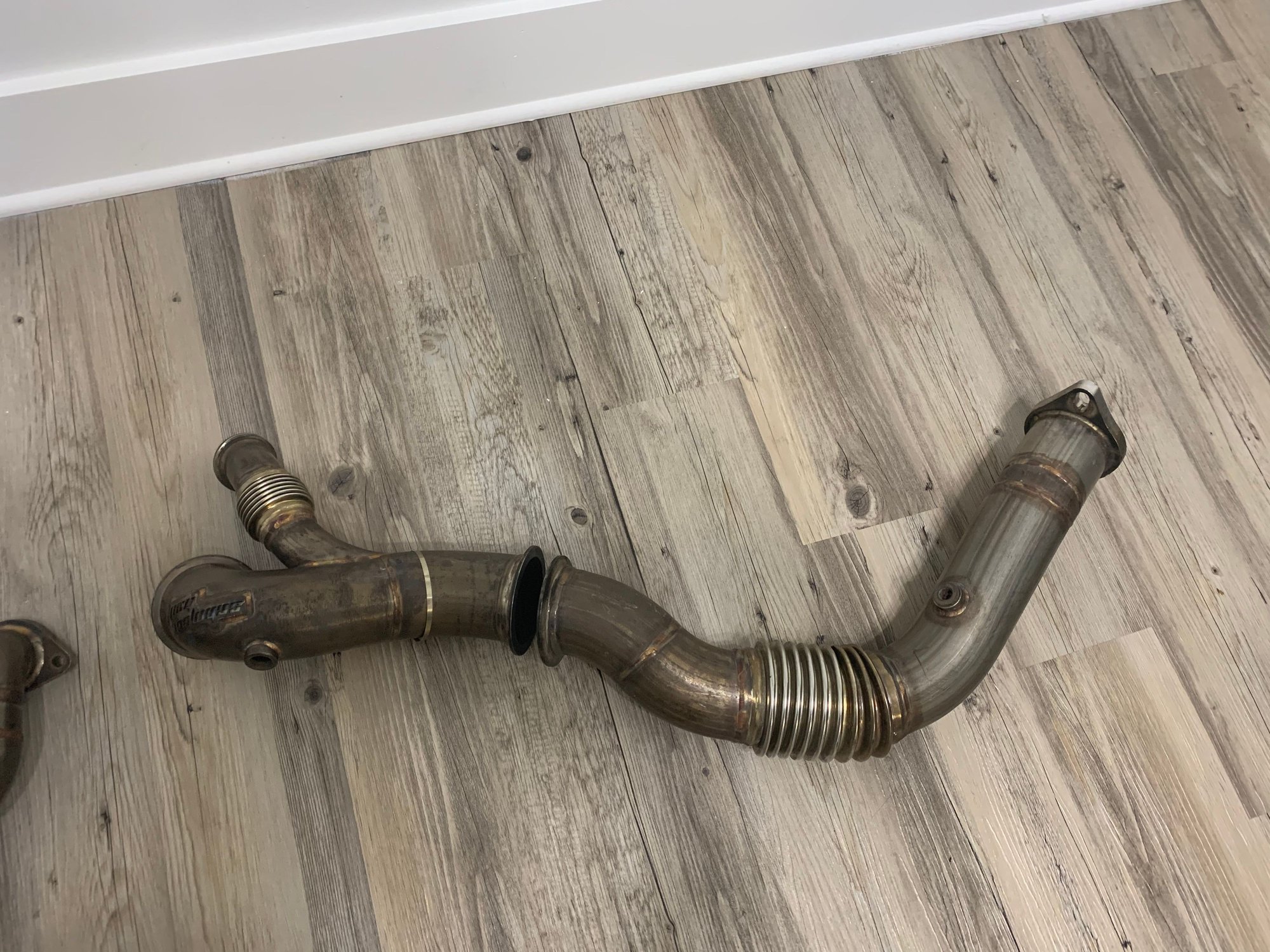

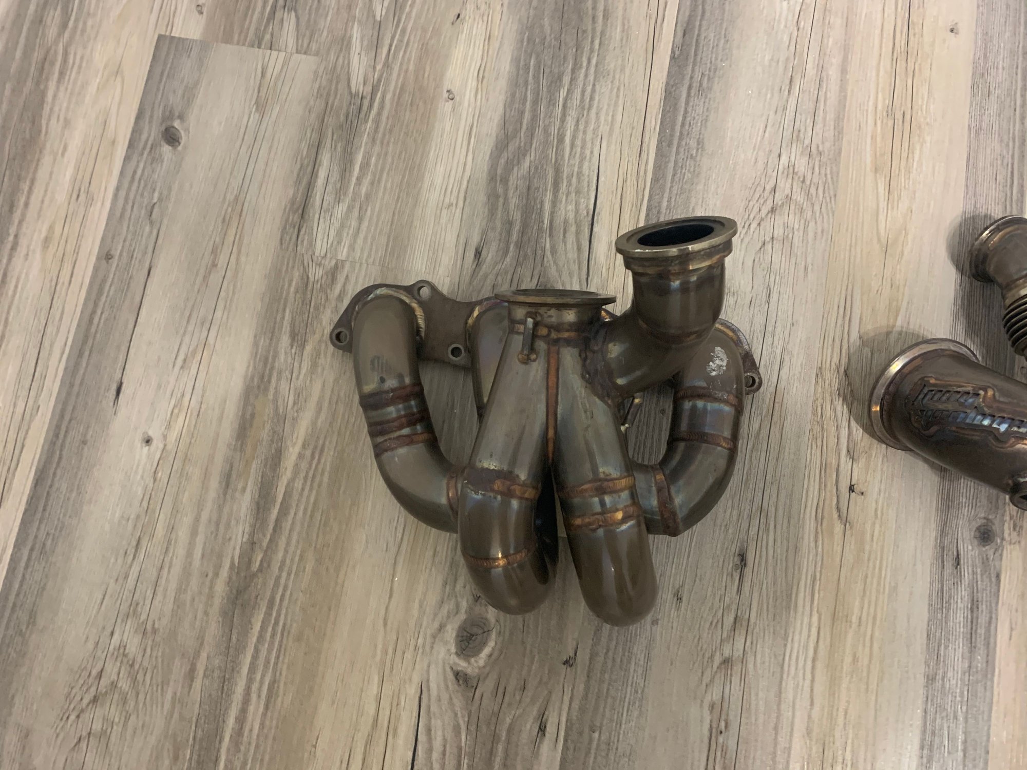

So I recently purchased what I believe is a custom manifold made by Jason Schmuck. I came across a deal I couldn't pass up and had to buy the manifold, I've always had a dirty dream of a top mounted v-mount setup and that's what I plan to do. I'm hoping a SOS v-mount setup could be adapted to work with this manifold and for now that's the goal, as long as budget permits. For power I'd like to make somewhere in the 500-550whp, the ultimate factor will be how well the drivetrain can handle that task. This isn't a purpose built car just a fun street car I'd like to be able to do a little of everything in roll racing, drag racing, autocross and HPDE. Oh and this is my daily so yeah...we'll see how long that lasts
QUESTION:
I also just purchased a AEM V2, although a friend of mine is interested in trading it for a PTE6262 BB turbo. I'm really only versed in Garrett turbos but I think it might be a little big for what I'm looking for but the chance of me finding a used v-band turbo that will fit my application probably won't come up again so I'm wondering if I should go for it. I could always source another EMS so I'm not really worried about that but I'm interested in s2ki's opinions
I also just wanted to share as tubular top mounts are pretty uncommon and it's a manifold I've never seen before I bought it. Cheers.

i can second that! i have a twin scroll schmuckbuilt manifold on my s2k... no v band though. his work is incredible.

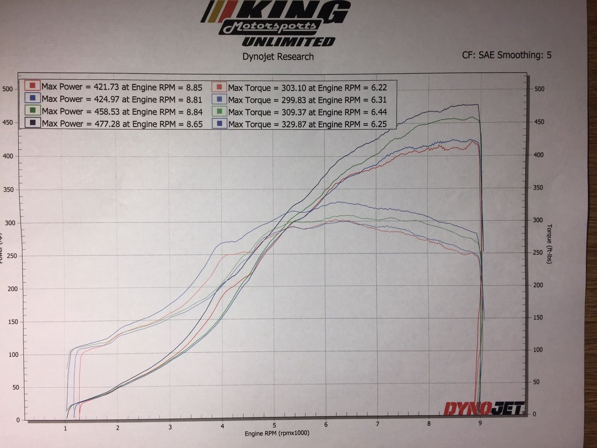

I’ve got that manifold and the Garrett G25-660; really happy with it so far. Also made my own v-mount. Is that the manifold on FB that cracked at least once?

How much power are you making and what is the spool up time like with that turbo? turbine size?
Old Feb 22, 2020 | 06:11 PM
s2kfinesse's Avatar
Joined: Aug 2013
Posts: 307
Likes: 8
420 on 93 @~15
477 on e70 @~15
recirculated dump
the other two runs are on a different top mount with Borg s256 and open dump. 93 and 100 octane for those
