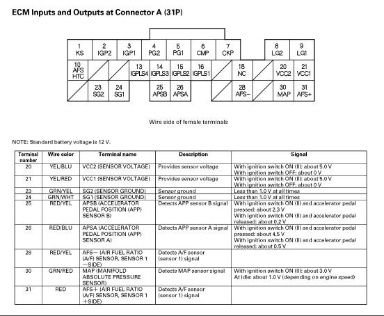

Are there any displays that are compatible with the OEM Wideband for MY06+ models?
Based on this ECU pinout for the primary 02 sensor, it looks like the AFR signal is differential...as opposed to a single 0-5V analog as with most Widebands:
