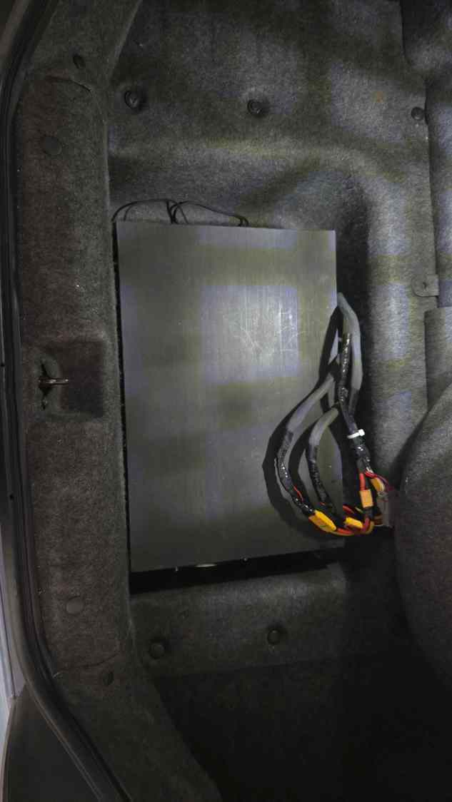

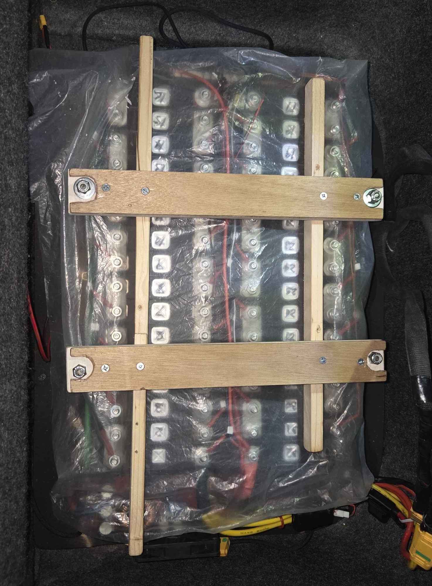

Cool project, do you have any pictures on the battery setup and spec on the cells?

The battery has a voltage of 84V and consists of 32 LTO cells in series. There is a charge only BMS and a 12V to 84V upconverter to continuously charge them from the alternator. The cells I am using are no-name (Generic) LTO prismatic cells. I could not find these cells any other way. There are brand name cells similar to these at 2.9 ahr and 10 ahr, but these fit in the trunk nicely and seem adequate. They are rated at 6 ahr with a C rating of 80, which means they can output 480 Amps. I need about 200 amps to get to 6 psi of boost at 8k rpm. These cells handle 200 amps easily - no heat, almost no voltage drop. They are durable and hard to kill, plus LTO is very safe. The only downside I can see is their weight - about 30 pounds for the complete battery and charger. At some point I may save some weight and replace this battery with the 2.9 Ahr cells. I expect the current battery has more capacity than I will use, the way I drive the car (street only). I figure this battery has about the same capacity as a 10lb bottle of nitrous, ie 100 hp for 100s, or 50 hp for 200 s. But of course it recharges itself when you drive, or it can be charged at home if needed.
