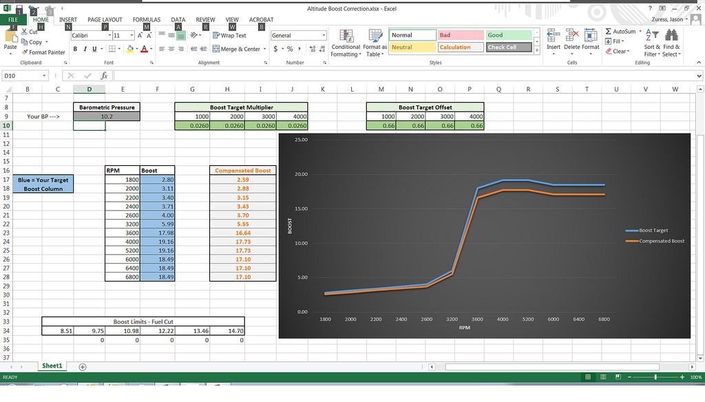

I don't know how they are applying it in that dyno, but barometric pressure is the atmospheric pressure around you. It'll change with altitude, heat, storm fronts, etc... Somewhere like here in Denver/Golden, I'll see 10.5-11.5 PSI (5,400 - 9,000 ft) of atmospheric pressure, but then I'll have customers in Omaha that will register low 14's for an atmospheric pressure. You'll use this pressure to calculate into tuning (absolute - atmospheric). On a MAF car, you can easily see how much less air you're flowing, given the same boost for an idea how much air you're really lacking. On many of the maps I've worked out with Subaru's, I have boost decrease as you go up in altitude, however, not the same for every setup. Someone with a larger turbo can push more up here or may be perfectly within the efficiency range of said turbo, so I won't have to bring it down so much at higher altitudes. On my personal Subaru, I run 23 PSI here, 25 PSI around 900 ft ASL, however, the turbo does have enough breath to run 25 up here, I prefer not to work it so hard.
I ended up making a spreadsheet for the way some of the older Subaru's calculate boost compensations based on baro. It just made things easier for me to plan out, input numbers into the map, and have a visual... I'm a visual person. This only covers targets, not what WGDC comps, which I adjust accordingly as well..
I don't think I have ever seen compensations like that on ktuner or even flash pro for that matter.
but I did see my map (total psi) per Hawaii DC decrease in boost in Co. Springs by almost 2.5-3.0 psi
Thanks for all the info. Great stuff man!
