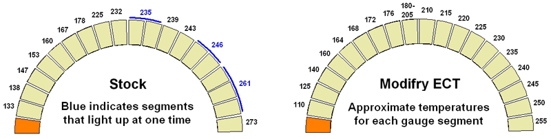

-The car had a small coolant leak from a small hose, but we fixed it before we saw any over-heating or any damage, we replaced coolant with Honda's own, and bled it. I'm currently running an AEM v1 with the modifry so I can see coolant temps, the normal operating temps should be at the dead center of the gage, or I think 10 bars out of the 20 in the AP2 (185-205 deg.).
Yesterday I saw it hit 2 or 3 bars hotter, but the car would go back down to operating temperature (10 bars) after I hear the fans kicking in, or even 1 bar lower in some cases. I know this isn't normal so I'm not using it right now. I took it to my trusted mechanic, he said it could be the after cooler radiator being dirty/clogged (exterior) and told me to bring it back later to clean it. There are no apparent leaks (coolant reservoir and radiator are both full), no bubbles in the coolant, and apparently no air in the system either (the heat in the car is searing hot), so I'm assuming this is not categorized as 'catastrophic'. I was also thinking the thermostat. The car does not seem to run hot while running faster than 40Kph. I just want to know if this is a true probable cause, and what other causes there could be.

The modifry gage:
