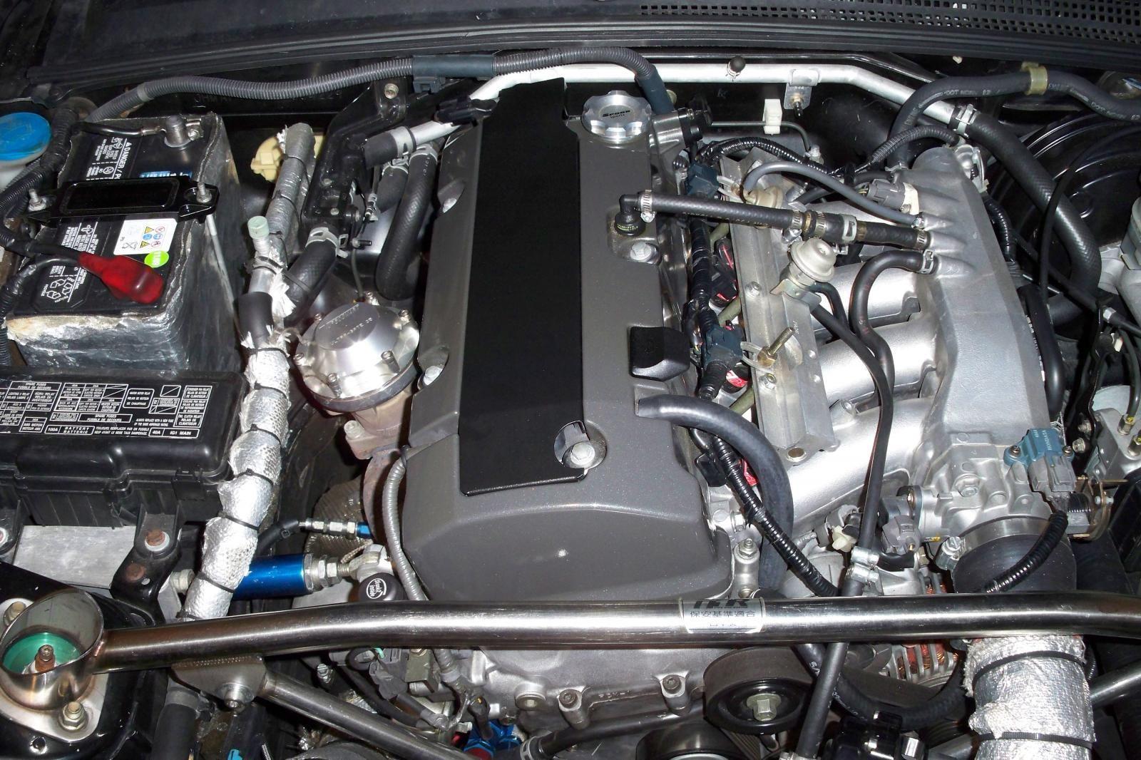

Just seeing if anyone is running an engine torque damper with a turbo kit, specifically the revhard one. It pretty much impedes the location path where it's supposed to sit.If anyone has done this and made it fit, could you please let me know. I have my ETD sitting around and would like to slap it on.

I used an NRG ETD with my rev-hard mani, it was tight but it fit without modification.
Not the best pic but this might help...
Attached Thumbnails ETD with Revhard manifold-25421_1367093850461_1025116106_31105436_4259938_n.jpg

I have a nrg with the puddydad mount and I have no clearance issues.

I think I know why mine is not fitting. I used a revhard manny but my kit is a diy and put together with different parts and the intake pipe. I just realised that my charge piping coming off of the turbo to the intercooler is pointing up towards the hood and then curves towards the front of the car, while these two are pointed down.
Oh well, I guess I can try and mod this thing...anyone have any ideas?
