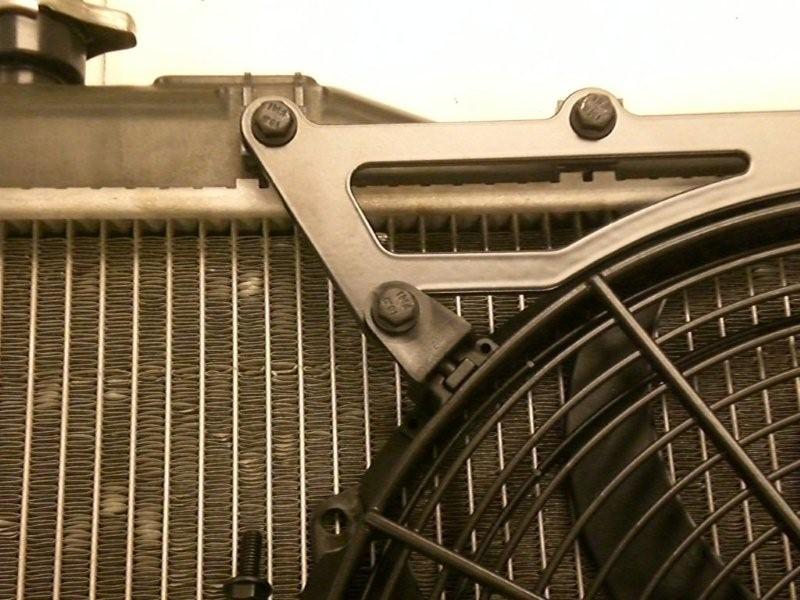

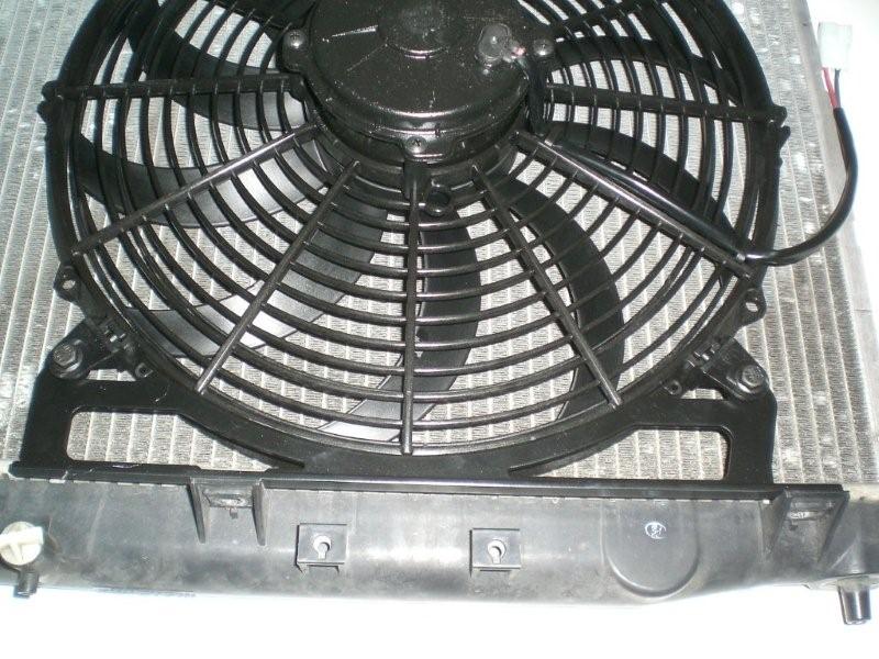

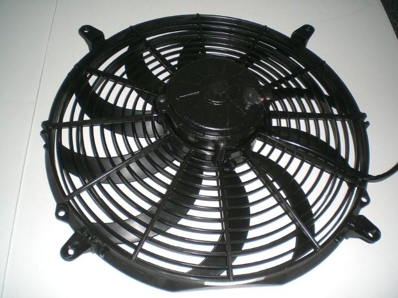

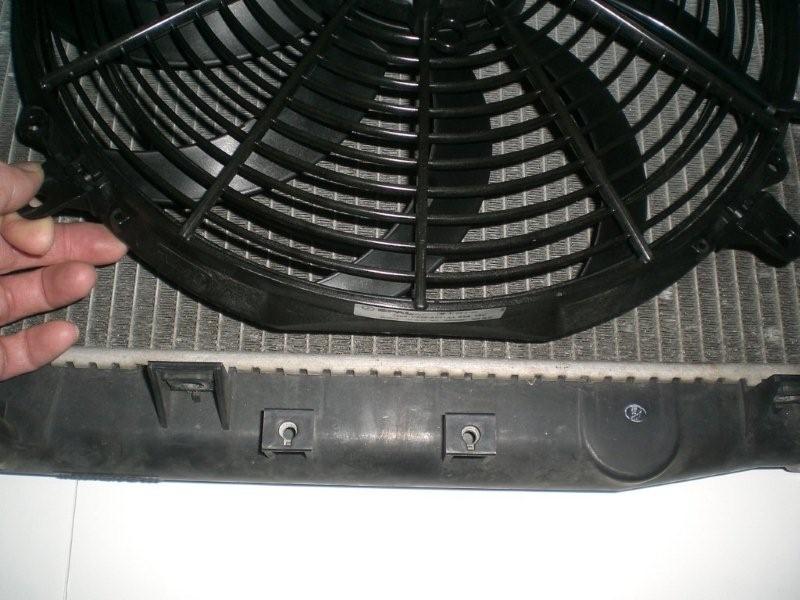

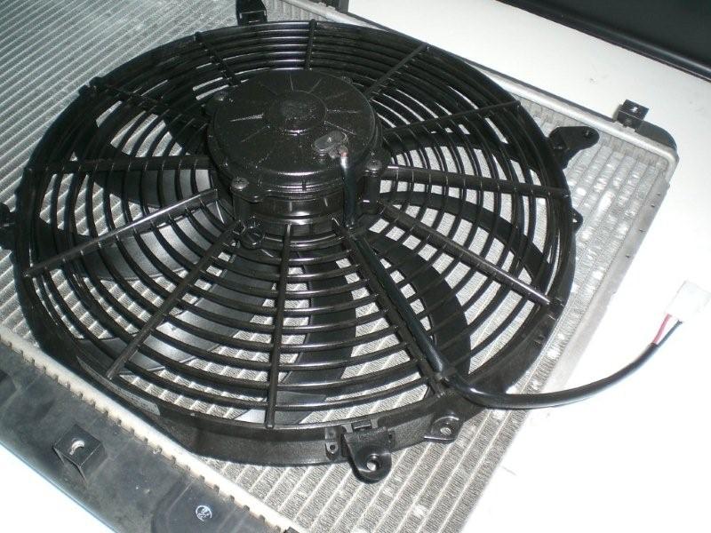

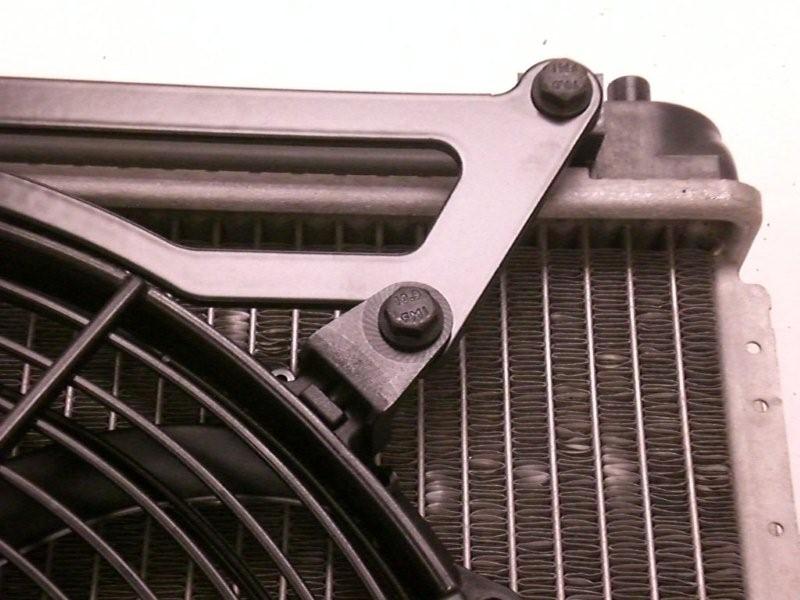

Your SPAL fan does not appear to be installed correctly. The fan needs to be mounted flush against the radiator (for the stock and Koyo radiator, we're not familiar with the PWR setup you have so you may or may not be able to mount is as shown below). The nylon fan mounting feet needs to be installed with flat surface facing up and bolted over the mounting bracket. The two flat edge on the SPAL fan should be at 12 and 6 0'clock position on the radiator. See pictures below:
MrC
