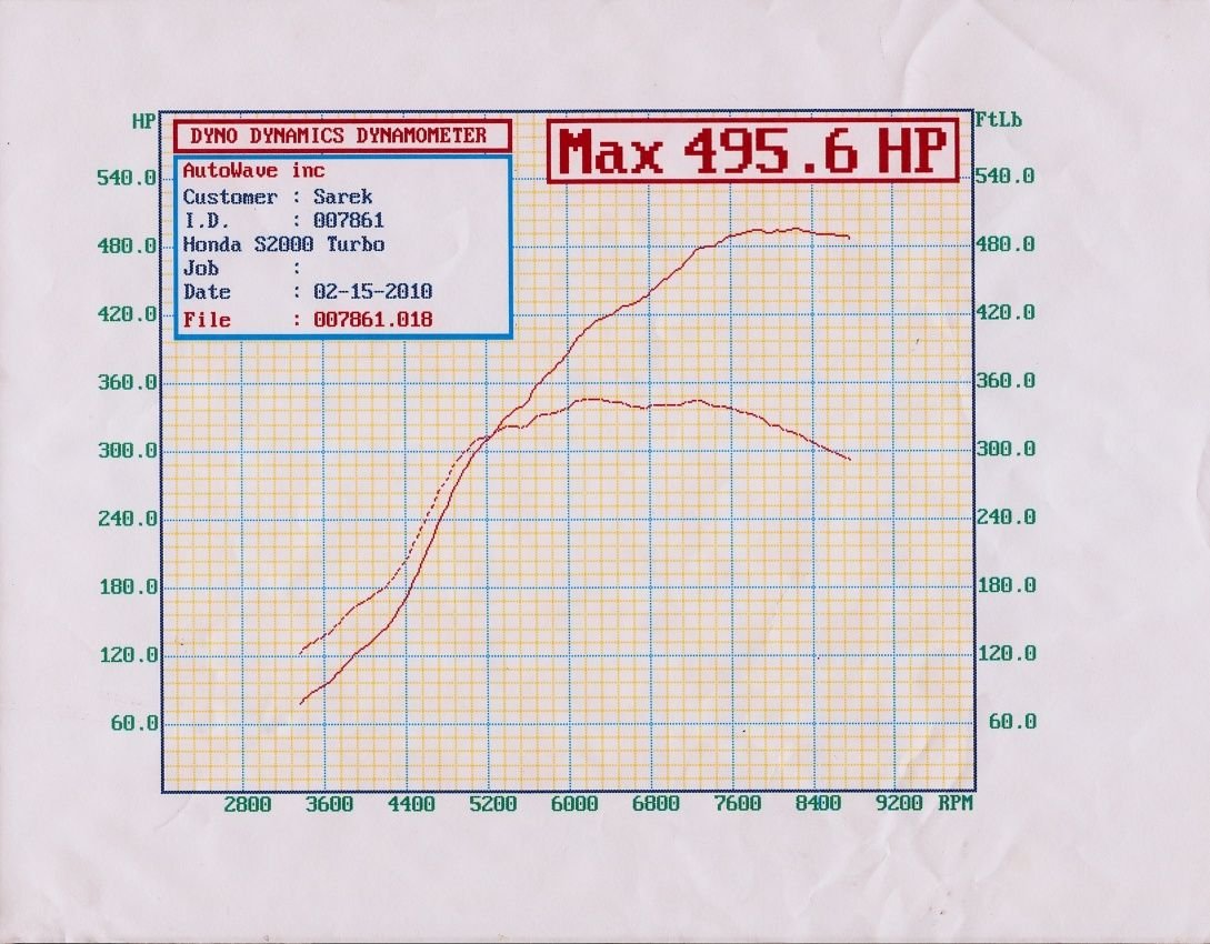

BEFORE: 184rwhp 129Tq STOCK
AFTER: Full Race Turbo = 522rwhp 380tq New #'s: 543rwhp 390tq with a much fatter curve! (overlapped are the previous dyno and a pull on just the wastegate)
boost
Mased in 2010 @ 18psi Dyno Dynamics
First Vid
unedited video
10/2011 vid
543rwhp & 390Tq @ 19.5psi
91 octane, 70*F ambient, 2200ft elevation and a high-flow cat.
tuned by Bisi Ezerioha

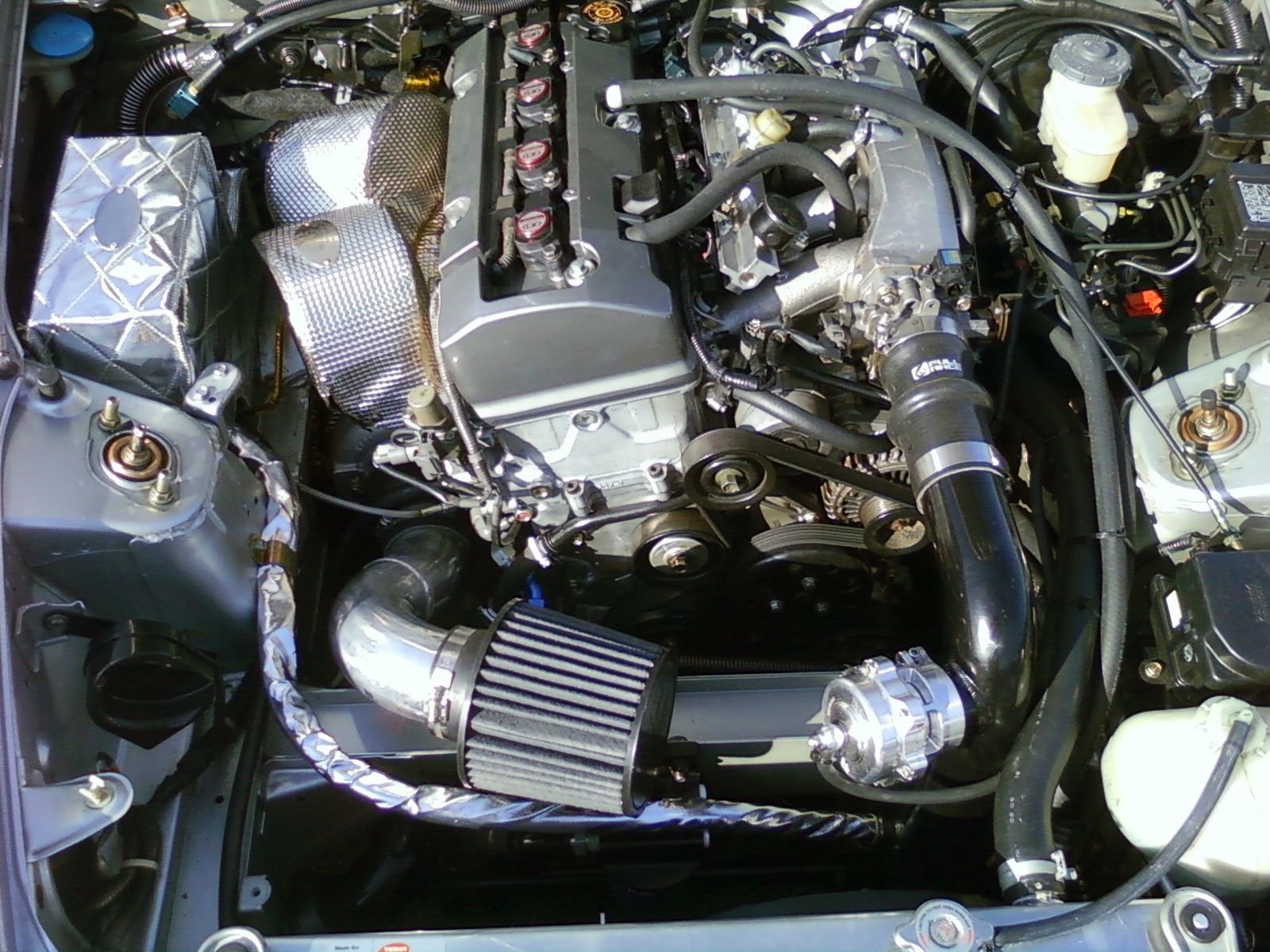

Engine:
-Full Race Turbo kit with GT3076r .82AR V-Band (Tial 44mm WG, 50mm Tial BOV)
-Custom V-Band 3" Stainless Dual Magnaflow exhaust with flat black muffler face and AP1 OEM tips and dump tube by Royal Muffler.
-Magnaflow (BERK) metal HFC
-Sound Performance 3" boost activated exhaust cutout. (Added 9/2009)

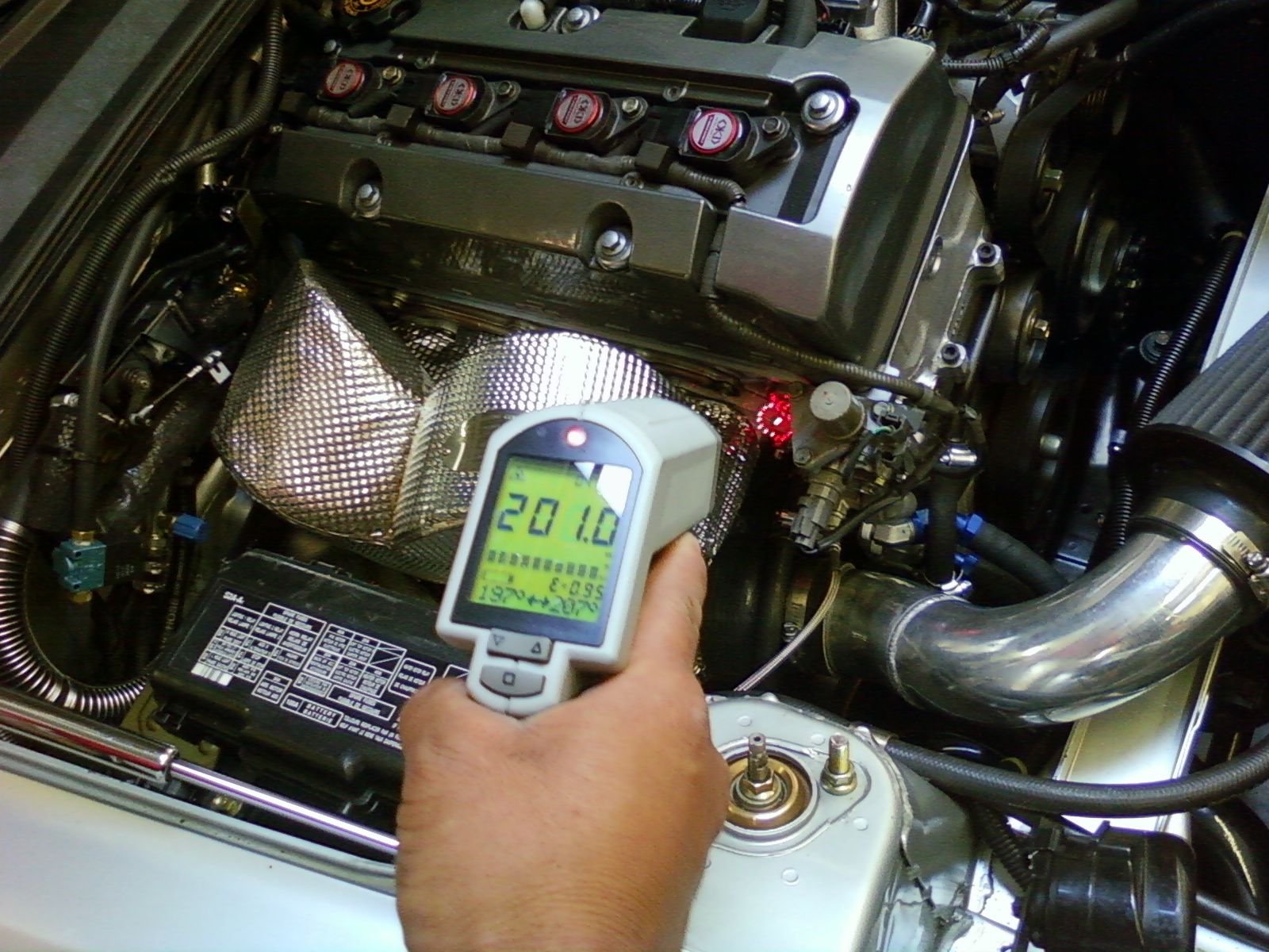

Temp Control:
-Visteon Radiator with extra 10" spal fan koyo with FAL 220 (integra fans)
-Custom Inconel heat wrap/shield on manifold, turbo, and downpipe by Advanced Thermal Products
-Custom fuse box blanket by Adavanced Thermal Products
-Swaintech White Lightning Coated manifold & turbo hotside
-Horizon Performance A/C lines relocation kit.

-Turbo to manifold bolts safety-wired with Nordlock washers! No gasket w/Hi-Temp copper RTV (Added 9/2009)
-ARP exhaust header studs with OEM header nuts and Nordlock lock washers to fasten manifold to head... so far so good.
-Black Anodized FMIC
-International Grind/Moddiction short shifter
-Custom 1 lb Stainless knob
-Custom Fuse Box heat blanket for my custom melted fuse box by Advanced Thermal Products

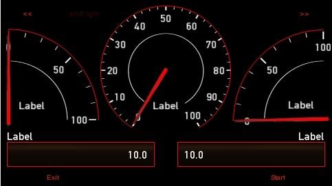

DashDAQ data monitoring
