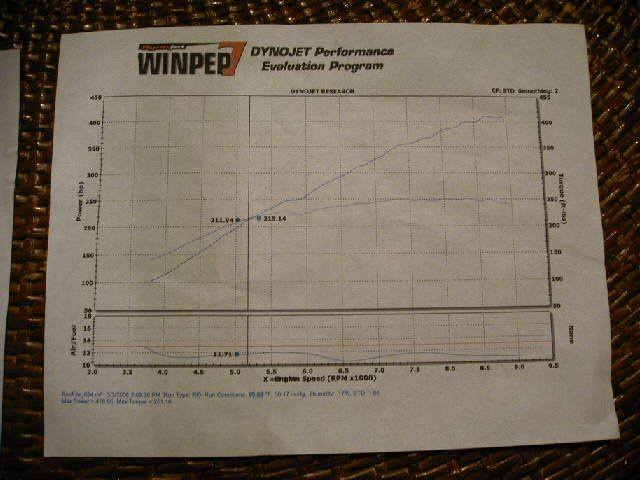

those are some nice numbers i also heard that Inline Pro ran a 10.90 yesterday on their setup

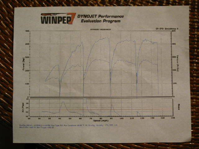

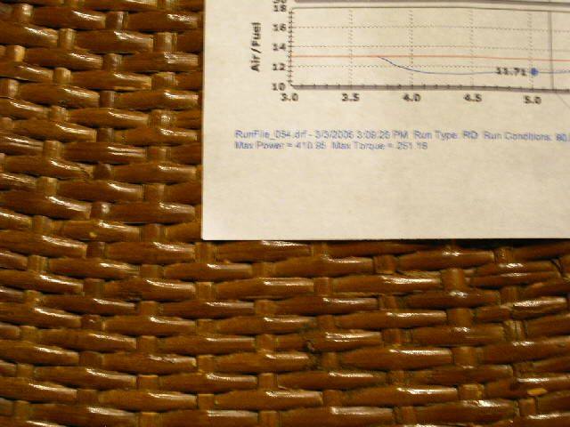

Here are some pics of the dyno sheets...
OG
