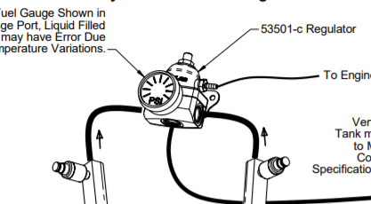

Originally Posted by yamahaSHO
I'm not fully caught up on this thread, but you realize you're utilizing both inlet ports and not the outlet port, right?
This particular FPR is just in/out only, it doesn't have a bottom port. Fuelab 54501.

Copy, I just looked up the "mini" model you mentioned earlier and took that snip from the instructions it came up with.
