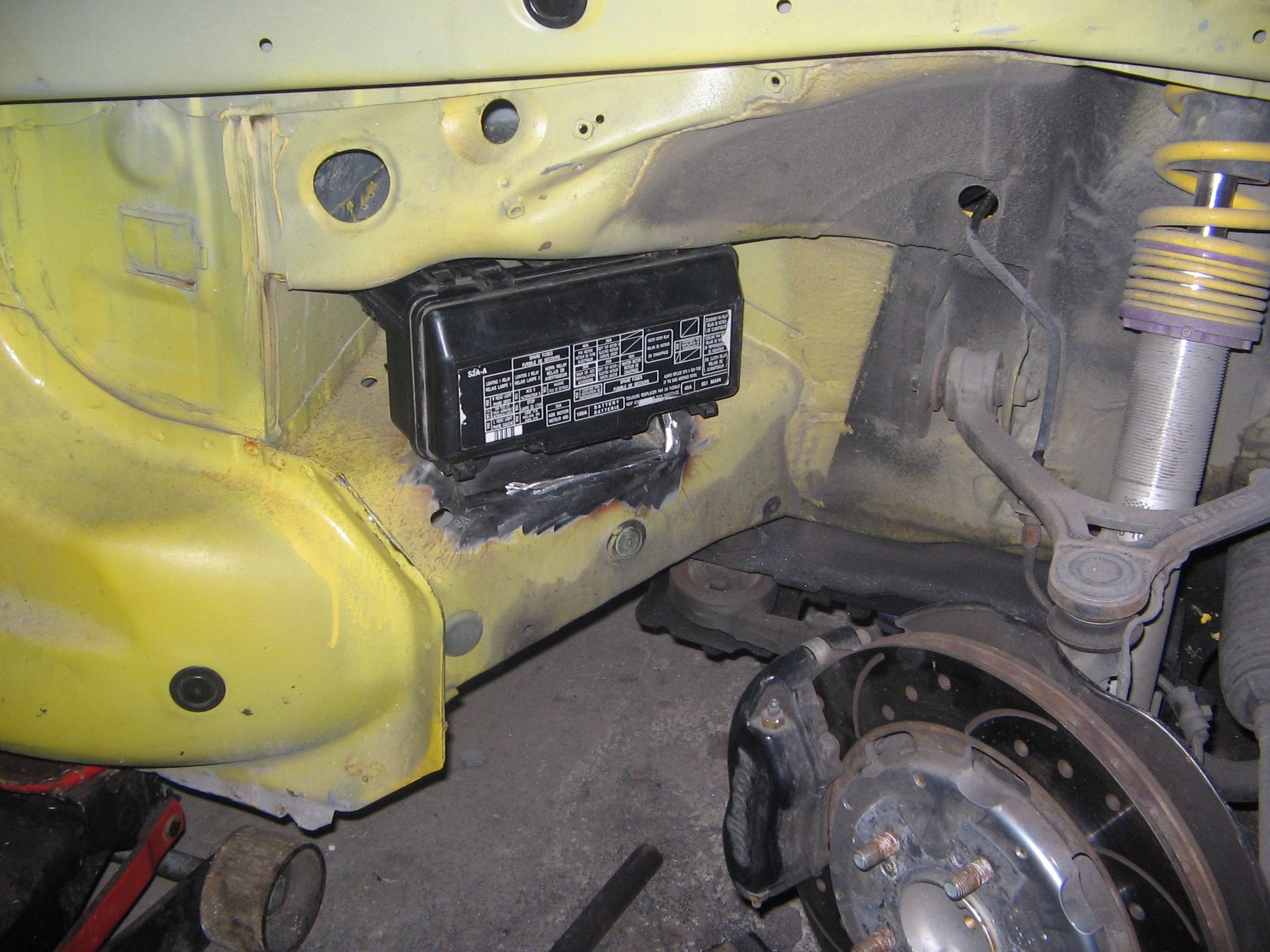

I relocated the fuse box to the passenger fender. Need to slightly bend the metal to bolt it down, but it clears the inner fender and can be accessed by bending over the inner fender.
I relocated the power steering box under the wiper shroud. Simply welded in studs to hold it down.

Fender ftw. Perfect and it takes a whole 10 mins to pull it off...
