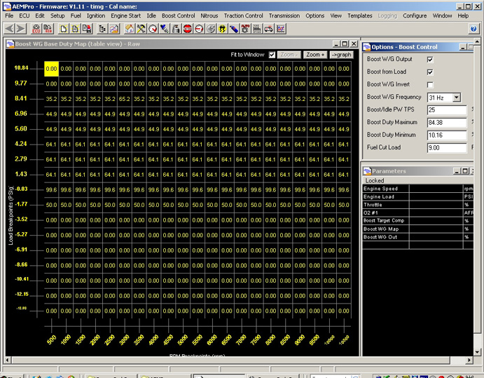

Any chance I can have a look at that map too? I am keen to see versions of the Boost Control as a starting point for my own.

I'm not sure yet. My boost gauge says its going all the way to 9.78psi and I have the target at 7.54? I have a lot of creep for some reason (I did before too). The tuners boost gauge also said 9.7psi but when I do data logging with ems it says 7.9-8.1psi at the highest so which one do I believe. The boost guage that I am using is the aem serial gauge which gets its info from the ems/map sensor. I will get out and do some data logging with it tomorrow and let you know what that says. Also it kind of feels like the spool up is a bit slower with your calibration, I dont know if that helps I am just going by what I feel which could be totally inacurate.

I must say the set up looks very different to others I have viewed.
I think this one came from Timg:
Notice the frequency.
Also the way the duty is 0 until the wastegate spring value at which point the boost control kicks in and then drops off as boost increases.
