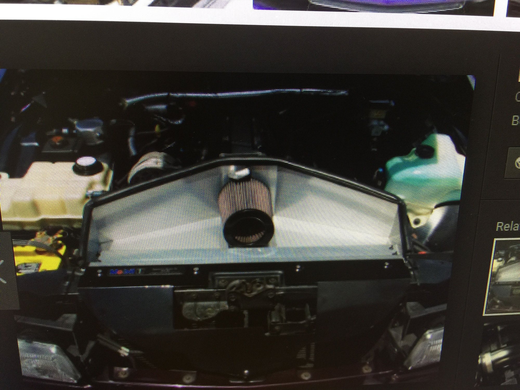

Old May 24, 2018 | 01:49 PM
nguyen365's Avatar
Joined: Mar 2015
Posts: 371
Likes: 9
U need something similar to this and an inlet from the hood
