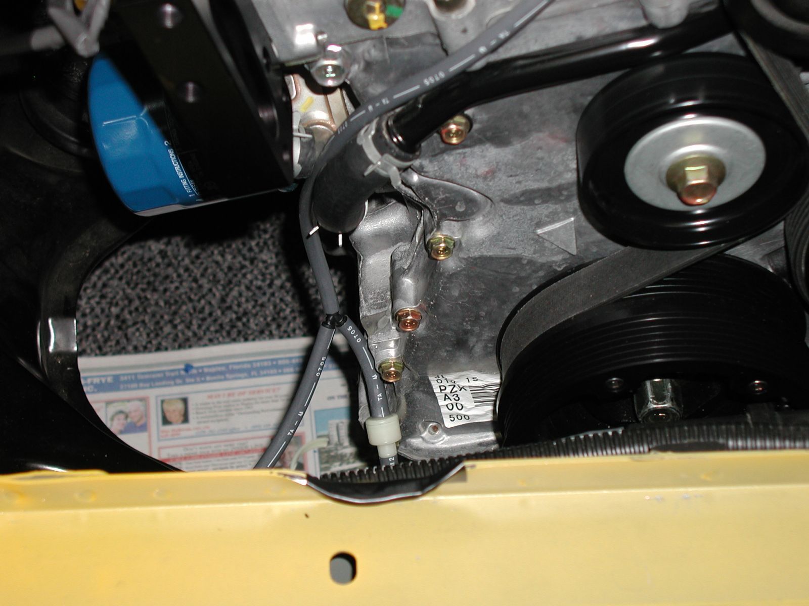

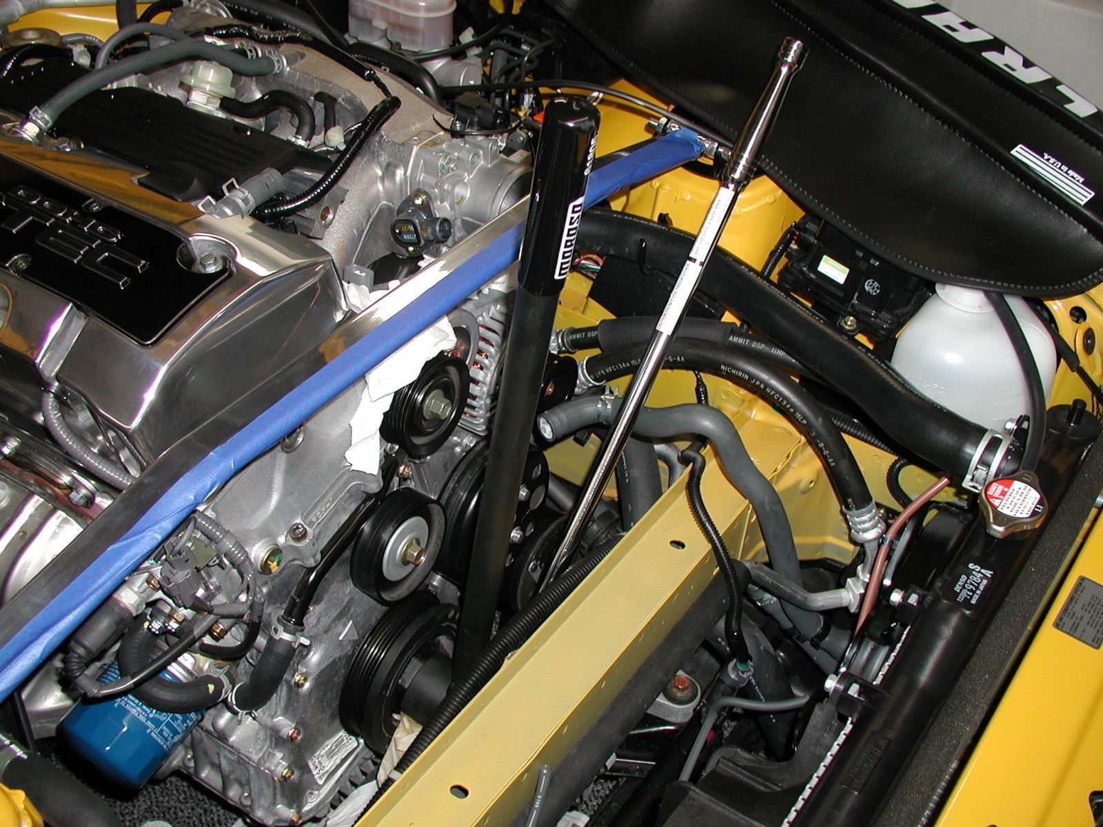

I have a vague recollection of this coming up when I did mine but it's been like 3 years.... Is the new drilled crank pulley fully seated? It should almost touch the block. There really should be enough room. I looked through all my old picts and these are not that helpful other than to show that it does fit. There's enough room to put two tools to get the stock pulley off and a socket to tighten the new one.
