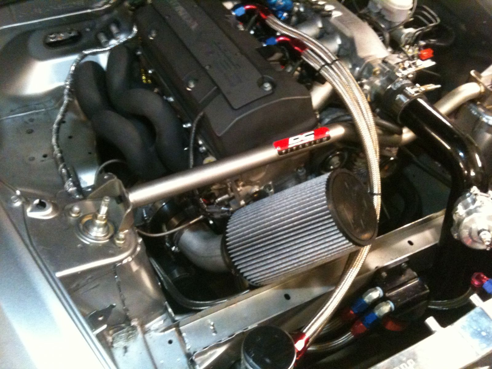

i cant check my wideband until I go home and hook my laptop up to it, i guess it could be the spark plug gap, but it has been running fine untiol today, and the only thing i changed was I added an intake instead of just a screen on my turbo, heres the new intake, i did use a 4" to 3" reducer coupler to make it fit

Easy diagnoses, take the filter off and see if it remedies the issue?
REport back.
I've seen plenty of filters in real life restrict flow, most were designed for an n/a application where they don't need the crazy CFM's a turbo requires.

I never noticed this before, but holy 90 degree angle batman !!
A sweeping radius is best, but such an abrupt turn, whew.

its a 45 degree bend, I didnt think it would matter that much. Ill know on my way home

or are u refering to the charge pipe with the blow off valve?
