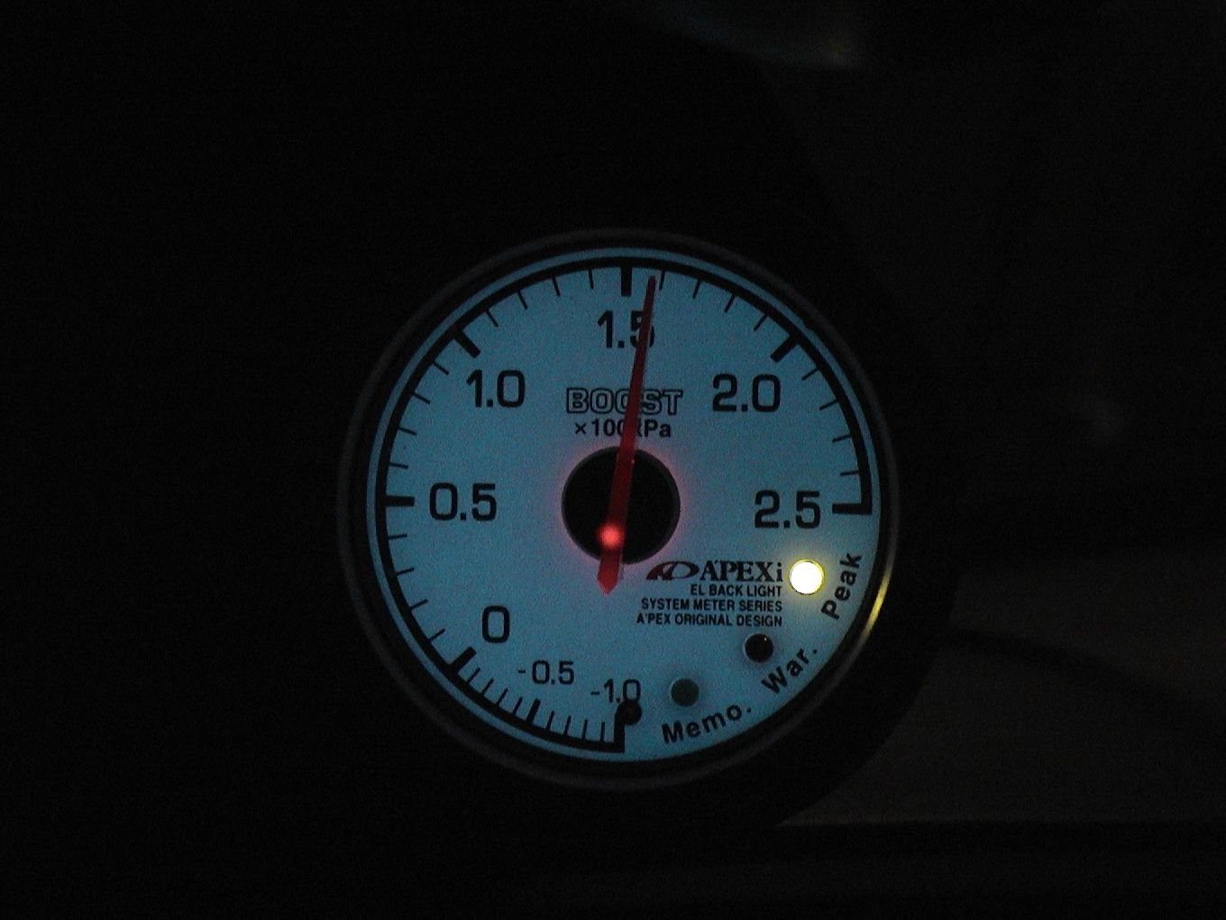

I've run the Vortech bov over 1.5 bar without dire results.
You will be fine below one bar (14.5 psi) of boost with the Vortech supplied bov.
If it was set correctly initially you won't need to adjust it.
