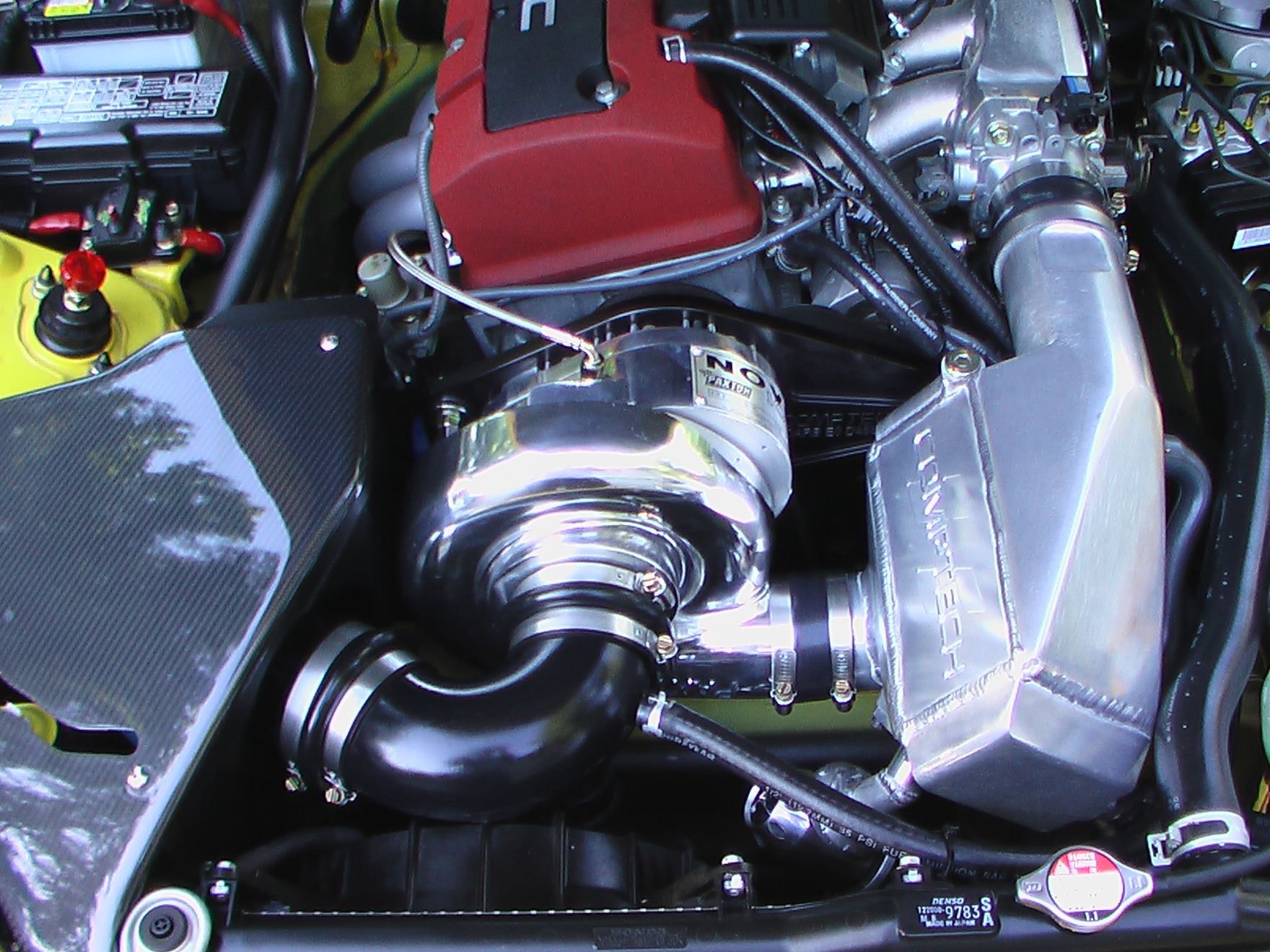

I am ordering my comptech supercharger soon and wanted a blowoff valve for it. What do I need to install a hks bov onto the supercharger and where could i get it? Thanks for your help!

It's going to require fabrication in order to get the hks on there. The Godzilla does not require fabrication. The greddys only require an aluminum weld of their flange to the stock aftercooler bypass flange. This allows the 4bolt to work with the 2 bolt.
The SSQ will require welding the stock bypass flange to the actual bov. This can be done for less than $25 and takes about 15 minutes. I would recommend that you buy the flange and weld THAT to the stock bypass flange.

i have one for sale! already custom welded onto the flange for the comptech aftercooler. i'm looking to sell it for $250 plus the flange from comptech that bolts onto the aftercooler. here's some pix:
i bought it brand new and only put about 3,000 miles on it. i'm selling it cause it's not a necessity for me at this time and i need a lil extra xmas shopping money. any offers, please reply or email me at gfer81@yahoo.com. i live in the chicago suburbs if any one out of town is interested.. thank you!
