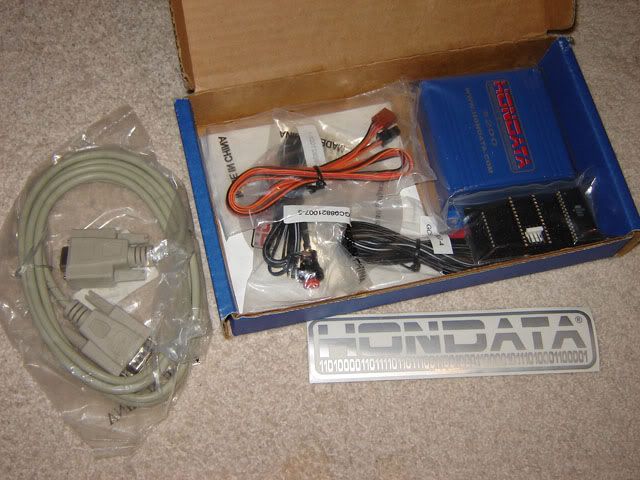

I'm looking at a aftermarket ECU to tune my VTSC'd S2000
I have seen many Honda owners choosing the Hondata S200 to tune their N/A or FI cars.
Is this an option for a SC'd S2000 ???

no
you will need either an AEM EMS, or some sort of piggyback like Greddy Emanage!

Those particular "modules" aren't available for our cars. Reason being, the OEM ECU (in the earlier 00-03 S2Ks) cannot be reprogrammed.
The only unit from Hondata that WILL work is the S2K-Pro, which costs a lot more money than the S200.

The S200 stuff is for 2 generation older PCM's than the AP1.
It's not going to work.
