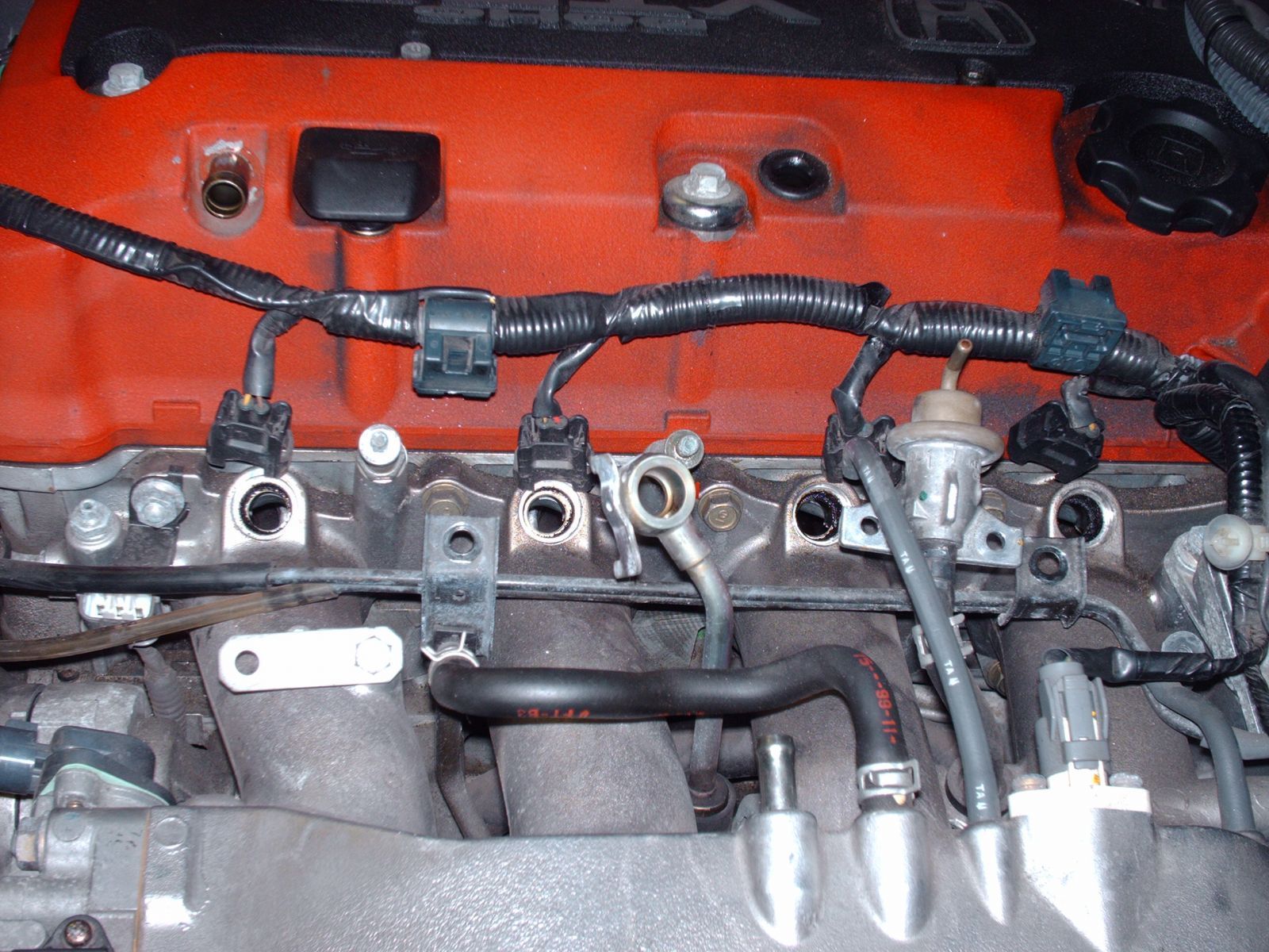

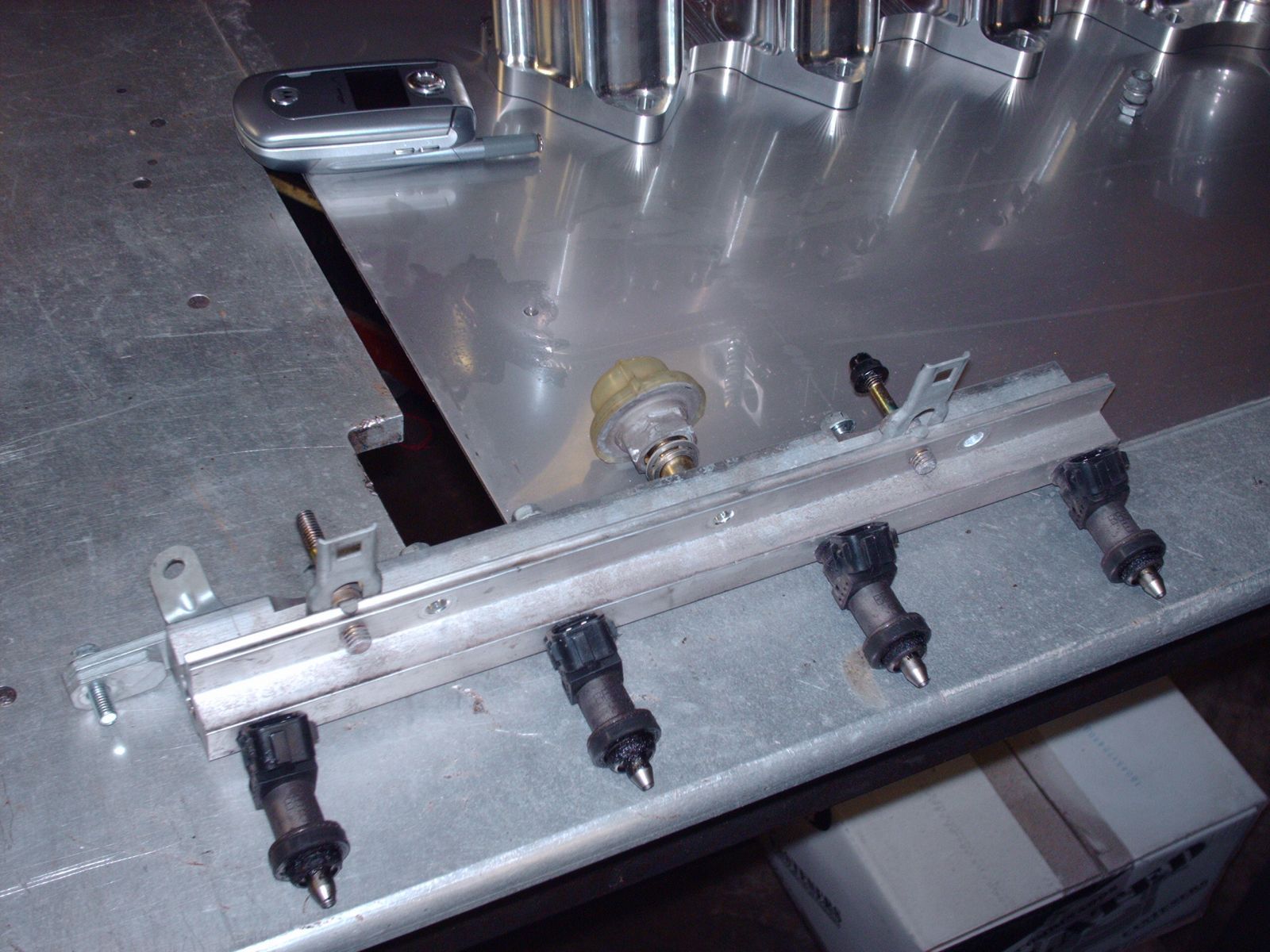

removed the fuel rail and injectors (should disconect fuel pump and run car till it dies to releave most of the presure in the fuel lines)
your going to want new O-rings when you go to put these back in

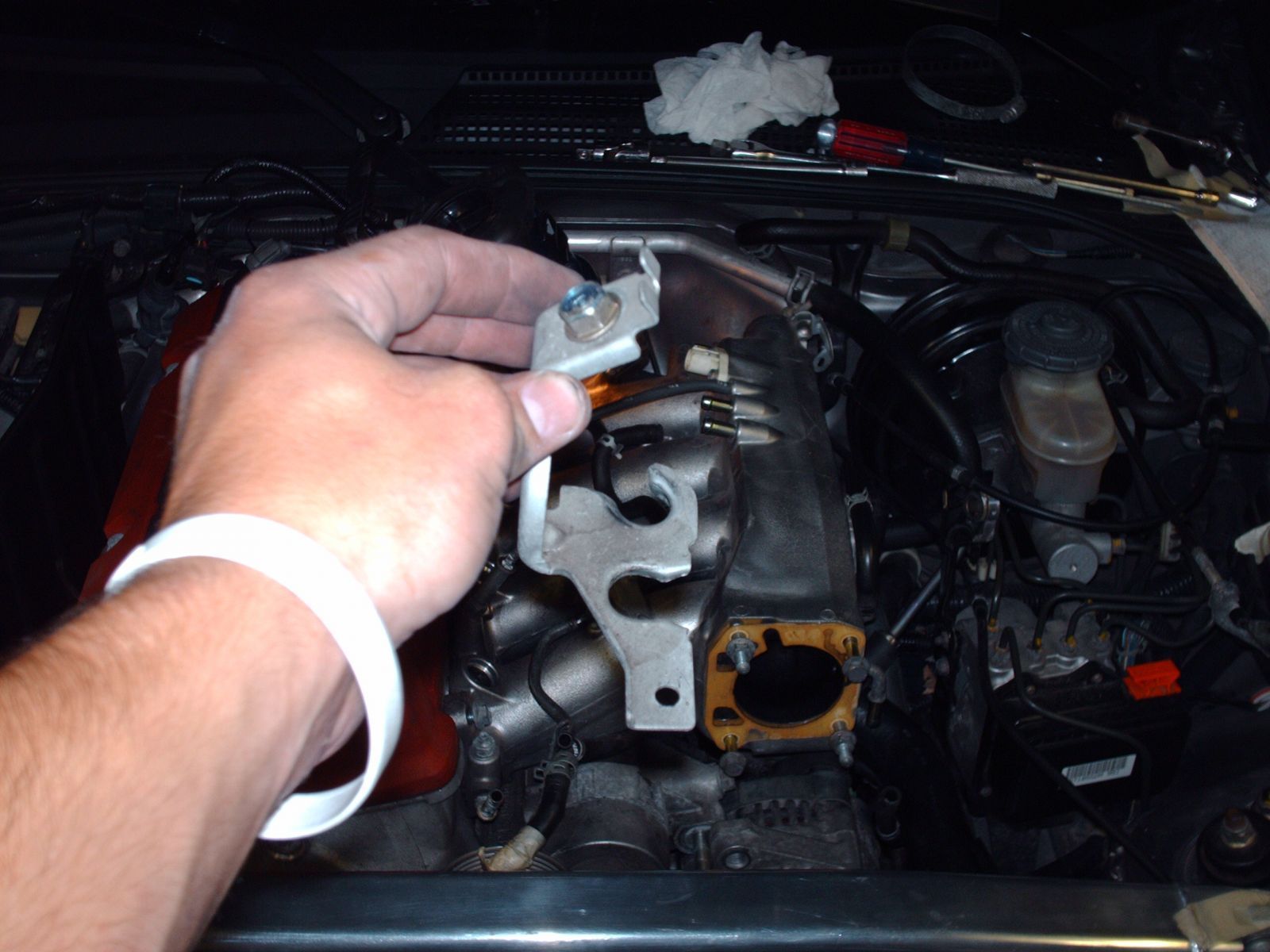

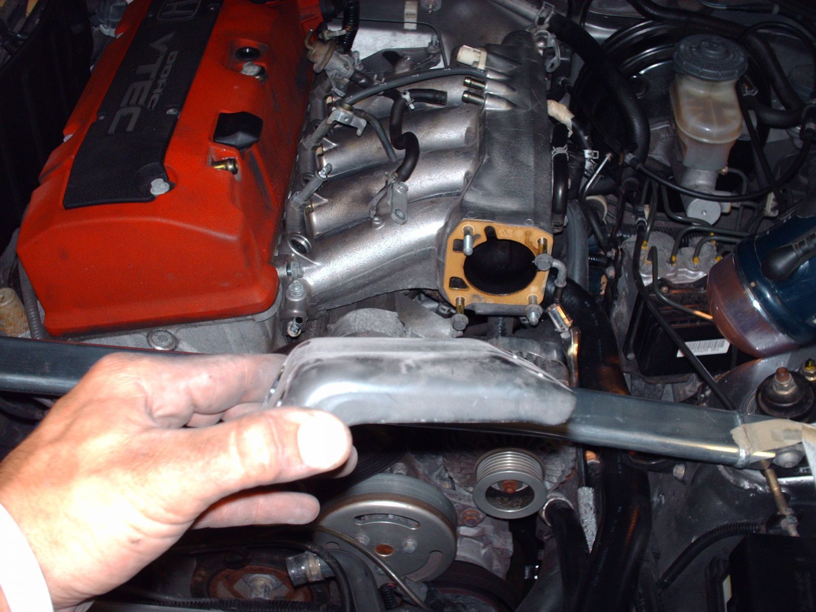

okay there are going to be THREE brackets of death as i have come to call them as they are going to be the bain of your existance when you go to take off the manifold. For the first one (closest to the front) You have to remove the belt and then take out the top alternator bolt so you can push it out of the way. as so...
and after some bloody knukles you get this... there were four bolts, two facing up and another two into the block.

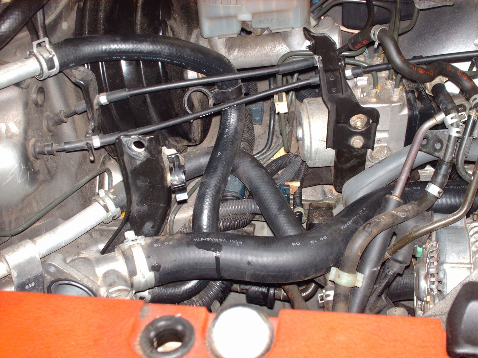

The second bracket (in the middle) is not as bad as the first but it wasn't easy. I had to leran some positions i didn't know i was capable of to get a socket down in there. but thats how it looks underneeth.
The third bracket is more of an inssue when trying to get the intake physically out, we had to pull back pretty hard on it and was able to get the clearance to remove the intake.

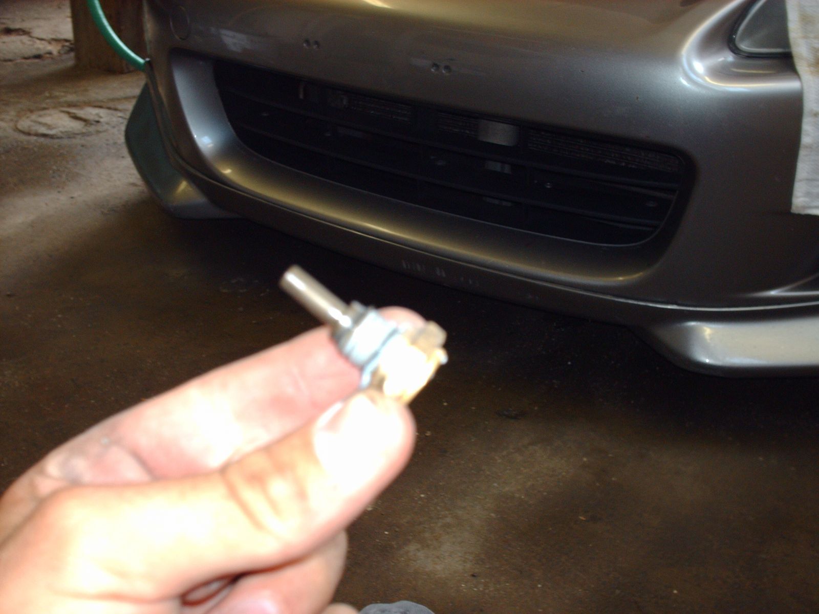

Now comes the ECT which shouldn't have been hard to get out but we somehow managed to snap it in two during the process.
we ended up using a screw to pull the broken peice out of the terminal once the intake was out...
