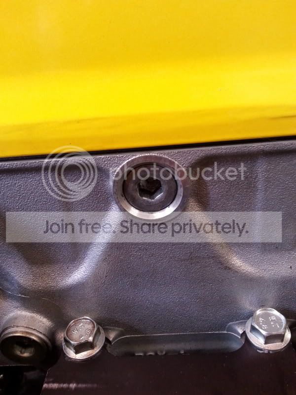

Can you show me a picture of the allen bolt on the middle front of the head that holds the cam gear in place?

Looks to be seated all the way, sometimes the washer on the front of the cam gear doesn't stay in place and it causes a tapping/clicking noise that's quite loud. Any videos of the sound of are you too scared to start it?
