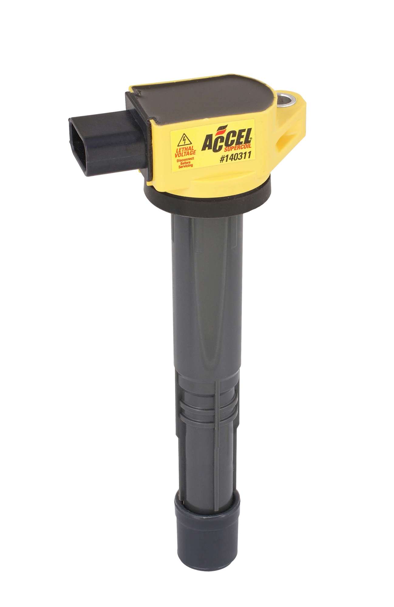

Has anyone tried the accel super coils? They claim 15% more spark energy.
Amazon Amazon
Old May 29, 2018 | 04:02 AM
AP1Chief's Avatar
Joined: Dec 2015
Posts: 812
Likes: 119
Hmmmm interested as well.

Too good to be true?
