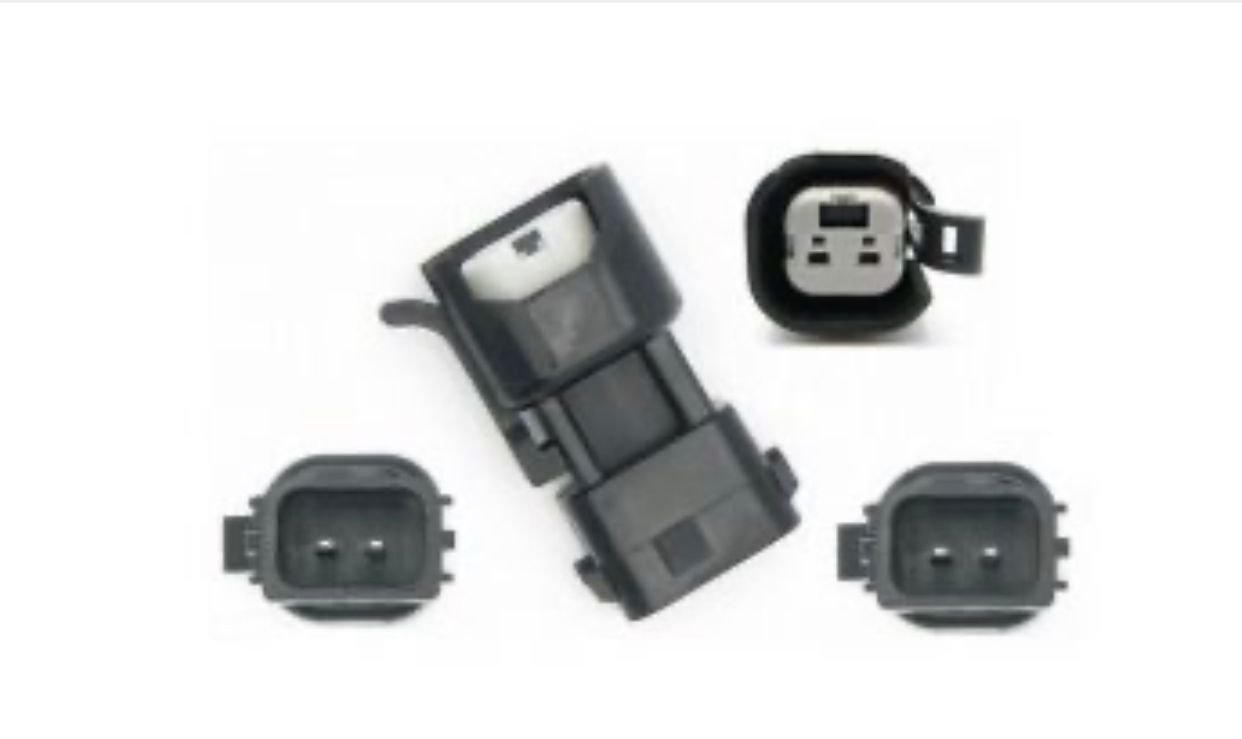

It's a USCAR connection. I ended up getting the adapter that goes from USCAR to OBDII and then just plugged in that way.
https://www.hamotorsports.com/produc...-inj-pigtail-1
This is pigtails, you would have to cut into your current harness or depin.
https://www.hamotorsports.com/products/uscar-obd2-1
Adapter, and what I ended up doing. There are likely cheaper alternatives so just seach USCAR to OBD2

Injector Dynamics 91.2 is the part number you need for the pigtail. Above poster is correct, USCAR to OBDII.
They also have these nifty solid-state ones now, I believe made by deatschwerks, not a pigtail, just a double-sided connector.

@EOE you can always buy an OBD2 pigtail set like this one from eBay and solder them back in, then use an adapter if you want a clean look.
