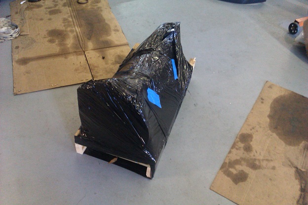

You should be quicker on the deals he offers you. I heard he shipped out that low mileage transmission today.
