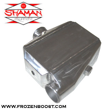

I've got the v2 KW kit on its way to me now, and hope to install this weekend. I too have been thinking about trying to do an aftercooler and win back those missing 2-4psi. Additionally, having less volume to pressurize, throttle response should improve as well.
Looking at frozenboost/siliconeintakes websites, I have a hunch of how i might be able to pull it off, but I want to have the kit on my car first to get some good measurements.
Basically, a 180° silicone coupler out of the efflux of the blower, and a short straight bit to this a/w heat exchanger, and then a short pipe straight out of it into the throttle body.
Unfortunately my car budget is completely tapped out with getting this kit and some additional bits, so it will be a while before I'm able to go down this route.
