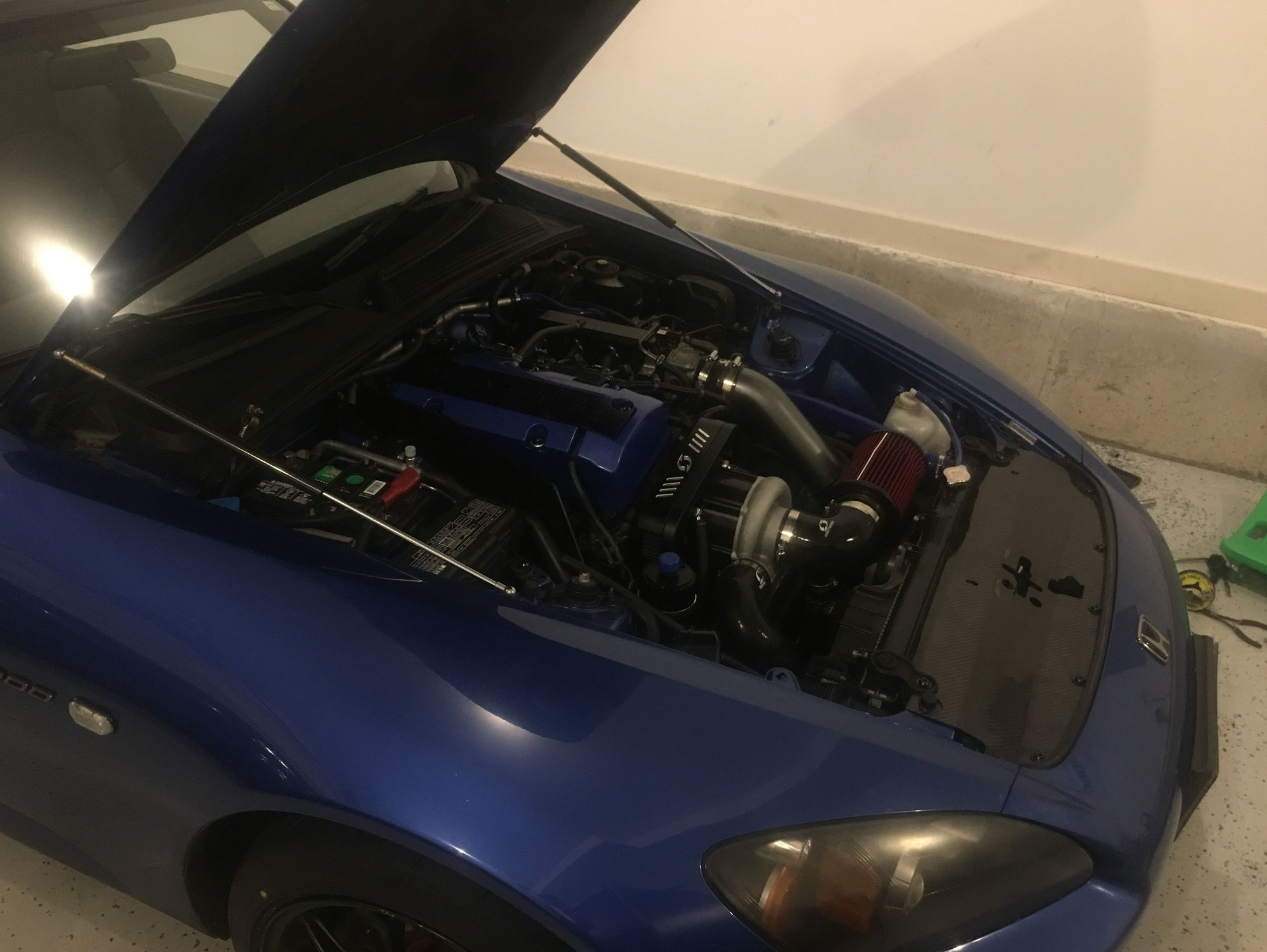

For starters, my name is John, I've been a member of the s2ki forums for a few years but overall have spent more time lurking then participating. I am the former owner of a 2001 Silver S2000 and current owner of a 2006 LSBP S2000. I have owned the vehicle since January of 2013 and have always desired finding a way to make the vehicle more fun to drive. Approximately 2 months ago, I purchased a Kraftswerks Supercharger kit with a Rotrex c38-91. Below I will post some pictures but sadly this story as of now has a sad ending. I received the kit approx 6 weeks ago, the install itself took approximately 6.5 hours and went smoothly minus the missing parts in the kit. I contacted Kraftwerks and within 4 days received the 2 cooler fittings the kit was missing, I uploaded the base tune and put approximately 300 miles on the charger while waiting for my tuner to free up. Unfortunately after 3 weeks of waiting and being ghosted by my tuner. I contacted a different individual that came highly recommended. This past Thursday I drove to the new tuner, however driving home I suffered from oil pressure loss resulting in lower end damage. I was able to drive the vehicle home, the vehicle still runs but current has 5 psi at idle and 35 psi at 3k rpm which is considerably lower than required. Despite the low readings the engine is still surprisingly quiet, however it is currently parked in my garage and will more than likely be receiving an inline pro short block & cylinder head come spring time.
Now obviously I didn't get a lot of miles on the tune (approx 10) prior to the oil loss condition, but I will absolutely say that the kit itself is extremely well constructed, the power was absolutely amazing and I cannot wait to reassemble this in the spring with the new motor. My current mods in conjunction with the Kraftswerks kit include a Skunk2 header, Berk high-flow converter & Megan racing cat-back (most likely replacing in the spring). Ballade Sports TCT, Hondata Flash-pro, ACT HD pressure plate, ACT lightened flywheel & factory clutch disc. In the spring along with the motor I will be installing a 90mm pulley (might as well make use of the stronger motor), and upgraded engine mounts.
