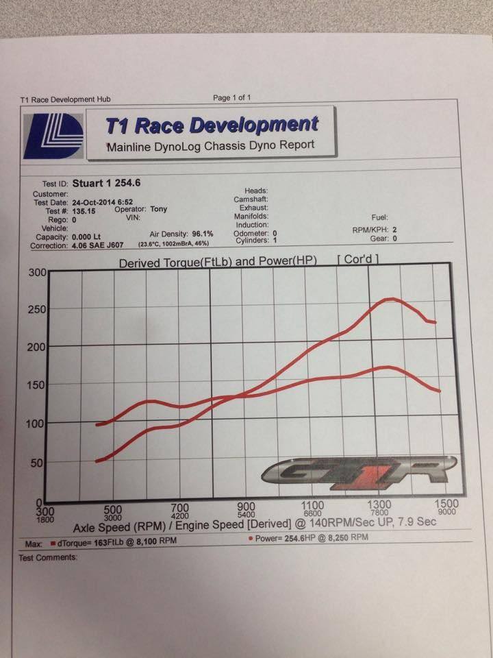

Great choice I'm at 487whp on gtx3076 fully spooled at 3600rpm. Not bad graph is like na motor. Depends on tune also and what gas..
Why in the world would you want your turbo car to have a graph like an NA motor lol?

I want 3x power with linear power band lol. Turbo lag is cool but I don't want it for my daily
You are missing the point completely. With a properly sized turbo you should have a much better overall powerband. My car NA and then with a turbo...
Mid range is significantly improved. That is with a turbo that is probably a little too oversized as well, you can make a ton more power down low/mid with a slightly smaller one. Again, why would you brag about an NA power band on a turbo car lol?
