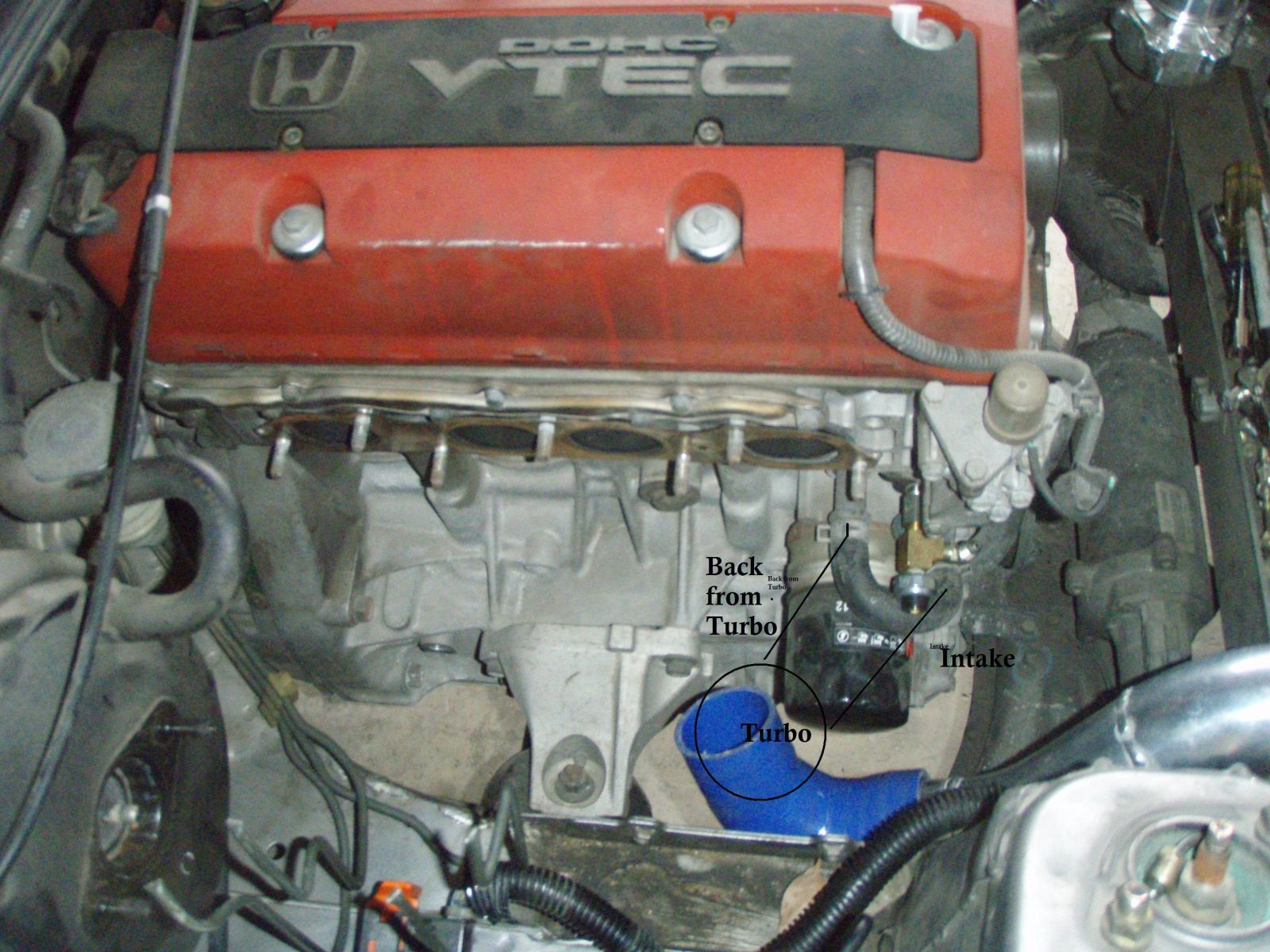

where should i pick up my water line for the turbo?
1) from the oil cooler to the intake of turbo, then loop from turbo to the return to the bolck as shown in pic......
any ideas!!!!!
cody said take the water line from the intake mini under throtle body? i am not to keen of this way, but how knows!!!!!

i did what you are looking to do...split the water lines in and out of the oil cooler and T them off for the coolant. Shortest possible way, and easiest i think.
