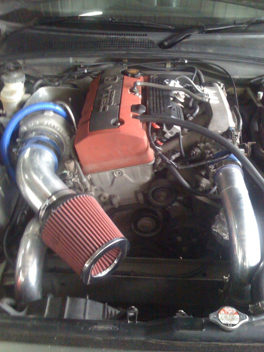

Well guys sorry for the wait, only now getting back to my build. This economy slump is making my pocket empty....!!!!!
Anyways I see you all make good use of this Forum, swaintech looks like a really good product.
Right, i finally pressed in all my hard rubber Mugen bushing and bolted all arms up. Also i put in my SPC Front camber kit and the Rotora 4-Piston Kit
ABS is out, i am takeing all four brake lines and connecting them to -3 line. I am using a double banjo bolt to connect them straight to the master cylinder. I had to machine the ends on the master cylinder flat to fit the banjo fitting. So what i am trying to say is..... 2 lines will come off one ports of the master cylinder for the front and 2 from the other port to the rear.
what suspention Allignment specs can i get with max caster? what are you all running?

Well guys finally done..
The car is up and running on the base map, I will start tuning on Friday when I have some time..
here are some pic
The ABS is out and using -3 all around straight to the master cylinder,

What did you do about your pipe that goes from teh valve cover to teh intake pipe?
I see a line going somewhere.....
I also have a mini-me setup and my IC pipes don't have a spot for that...
