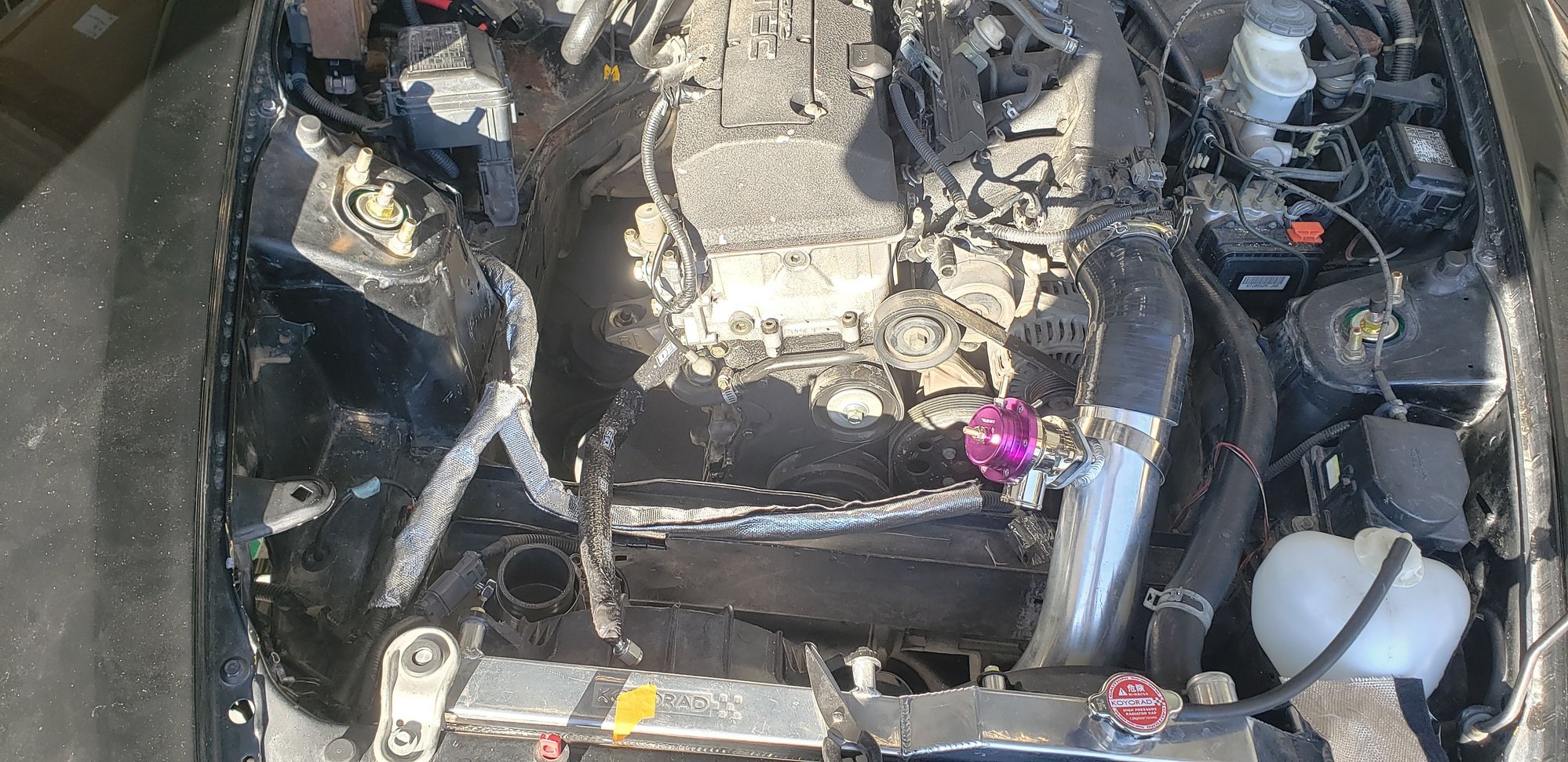

Slight engine bay cleaning and heat management done.

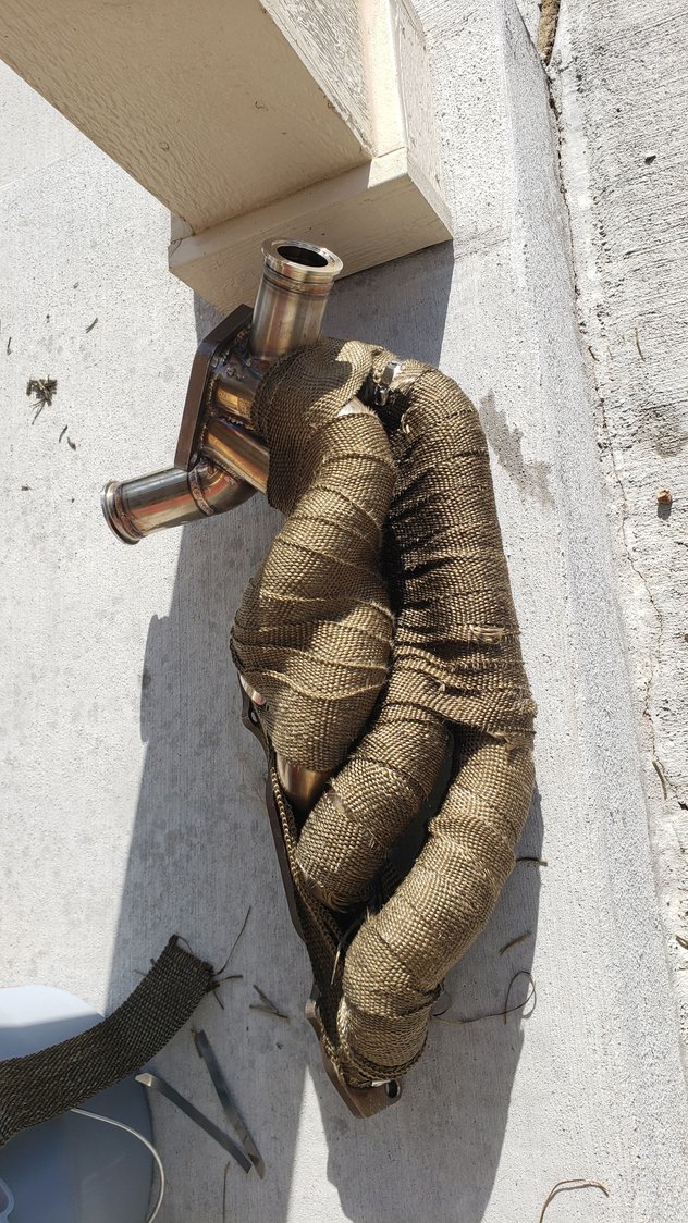

More heat management. Definitely doing this in titanium wrap next time.

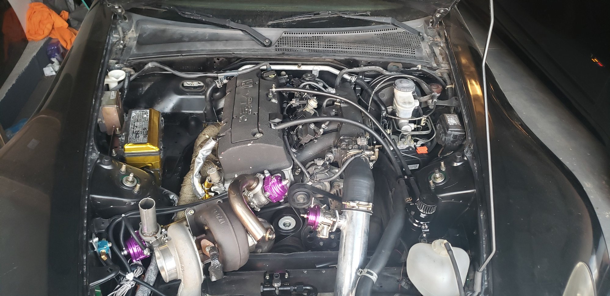

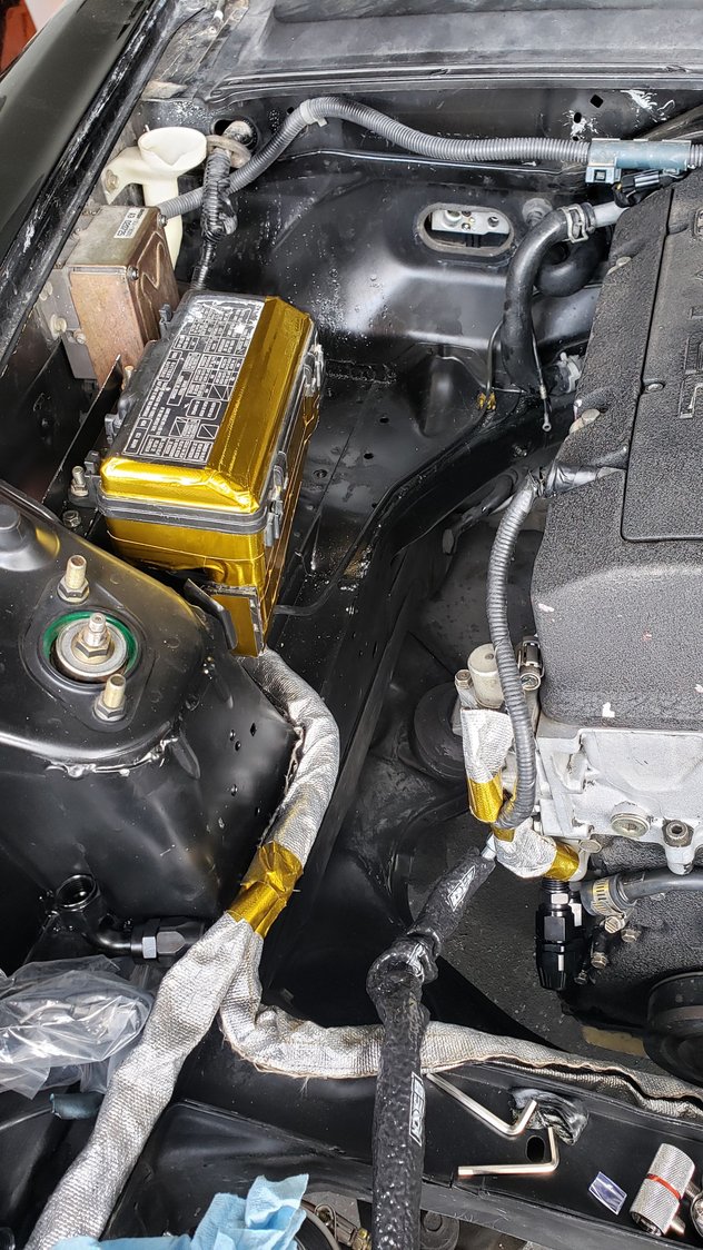

Mounted the fusebox which will need additional bracing, and removed the surface rust and painted the car. Also more heat shielding for the $$bling$$.
Kit finally install (Wastegate dumps are just there for now. I'll be going hood exit)

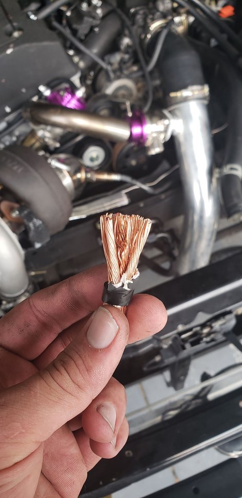

How the battery in the trunk was "grounded"

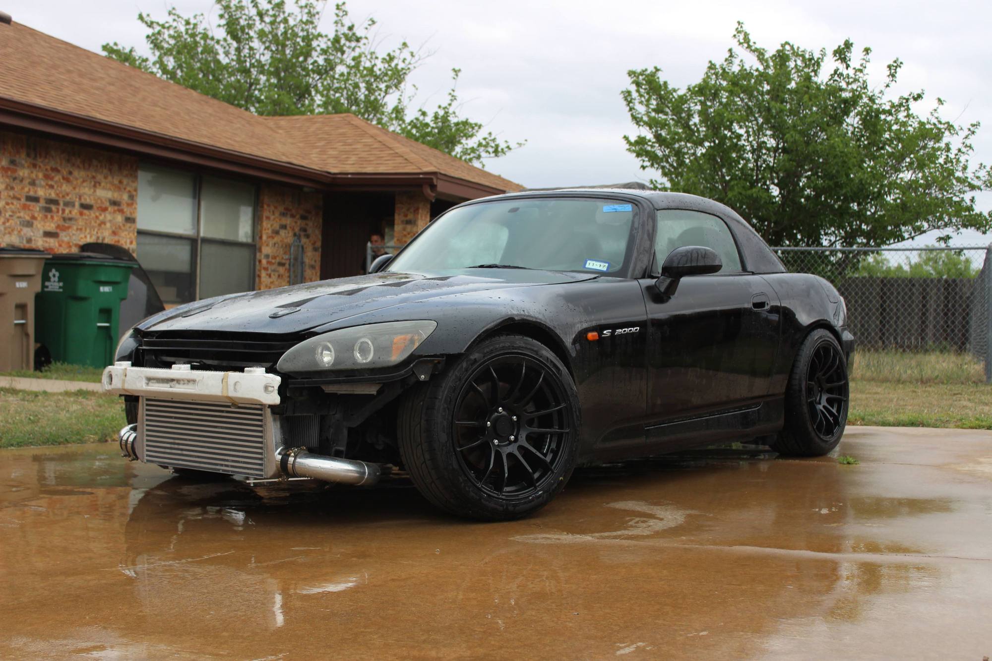

My yellow now black S2000 right before I dumped $3000 on nothing.
