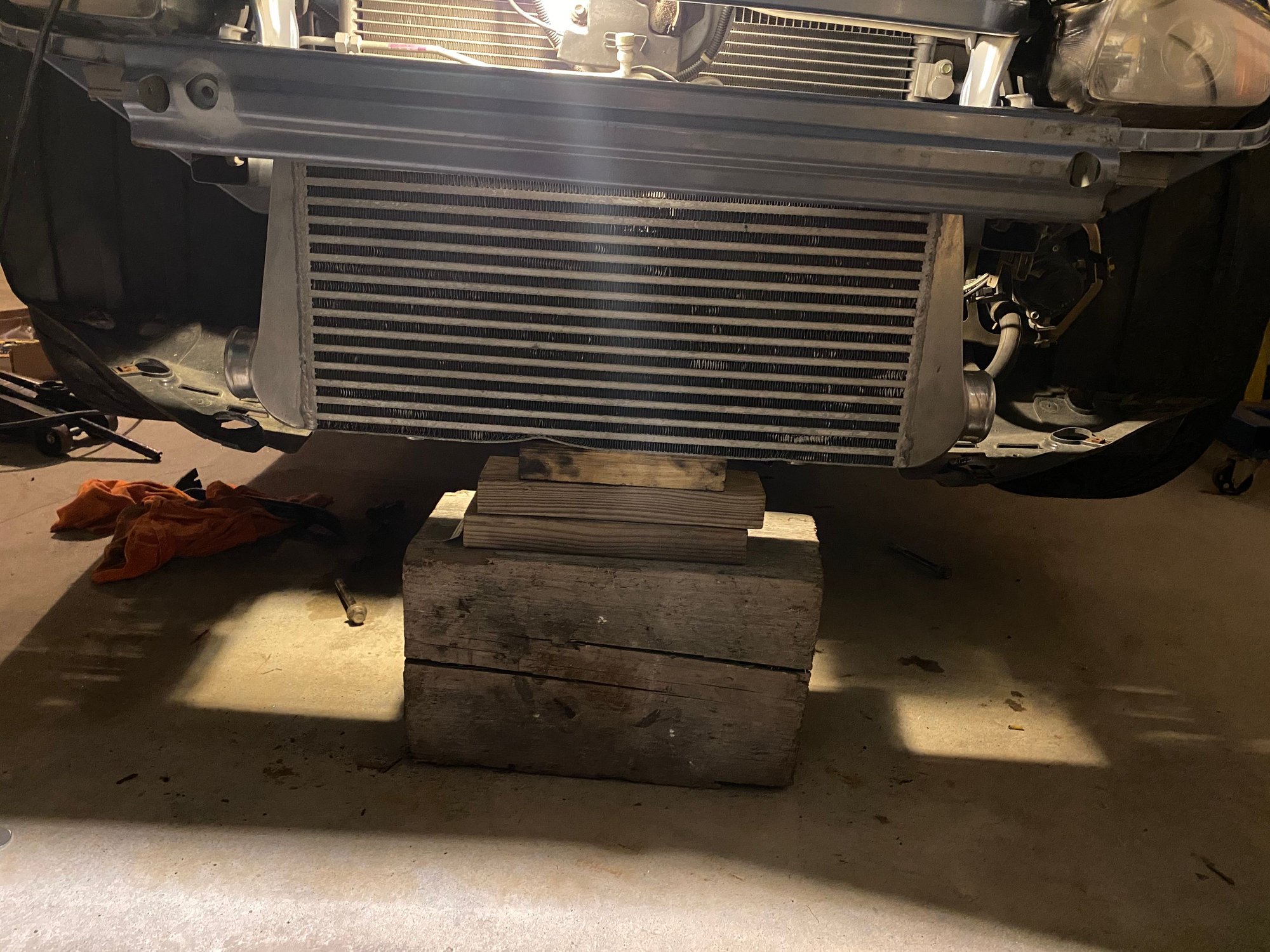

Mounting locations for intercooler.
Has threads in the top for bolts, so intend to use them with some iron cut and fabbed. What’s everyone using to mount to on the car?

Welded 2 L brackets together and bolted it to the car where the 2 8mm bolts are that hold the rad crossmemeber
