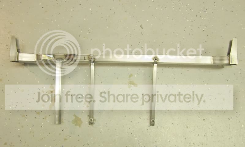

I bought exactly the same unit last spring and its working out great. This provides a huge increase in heat exchange area compared to the standard Comptech unit. I was shocked how heavy it was. There is a lot of aluminum there. This unit is about as big as can possibly fit and that makes mounting it more of a challenge. Here is a picture of the mounting arrangement I used. This is before adding gussets and paint. It picks up existing holes by the bumper attachments. The vertical bar to the left supports my methanol tank, so just ignore that.
