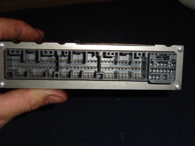

I bought aem ems setup from s2000_europe and i'm needed help with installing the wideband. He sold me a 1052 box but said it had been intergrated with the wideband setup but i have no clue how to wire in the wideband. I have the bosch sensor and the cable to wideband but how to I hook it up to the box???
he sent me one empty connector that fits into the open spot on the box but how do i wire it in?

there is a pic of the open connector

It's just plug and play. Turn on the O2 feedback in the EMS too.

It's not plug and play. You need to put in a wire from the wideband (unsure what color since I dont know which wideband you have) and place it into a 5v input on the D connector. There should be a pin and everything as well that goes in there. If you dont have the pin goto radio shack to get it and squeeze the wire onto it. Then put it in there. You will need to set on your EMS which pin it's in. Not O2 feedback.

sorry to go off topic but if you purchase the 1052-U w/ built in wideband do you still have to go and buy this wire you are talking about? Or is it true plug and play?

That is true plug and play. There is a port on the box itself with a connector that goes right in.
