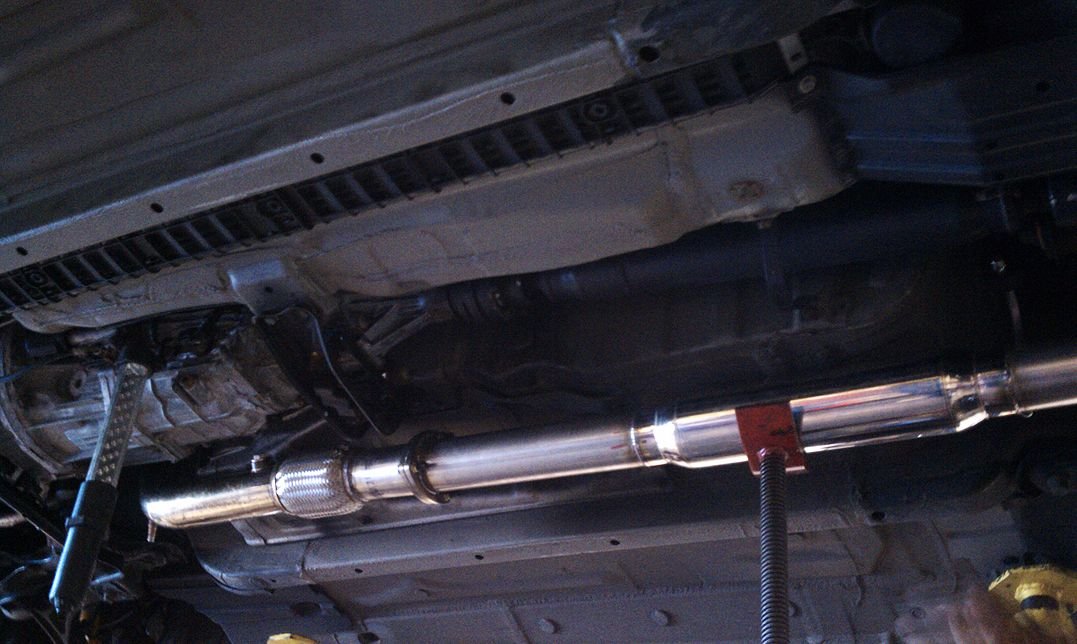

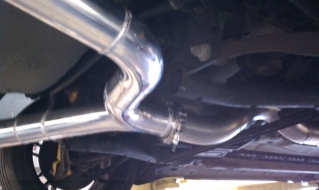

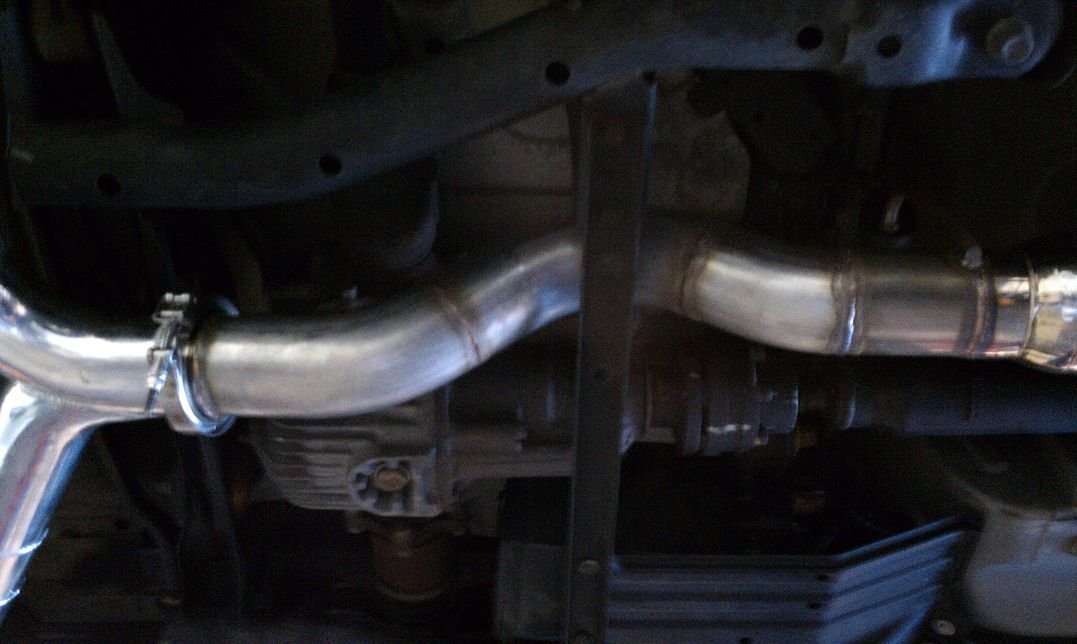

Finally got my new exhaust system finished up after over a month of running open down pipe. No one offered what I was looking for in a bolt-on exhaust application so I had something made.
What I did:
-Added a 3" Vibrant turbo-flex section on my ILP 3" DP
-Added a 3" Stainless Vibrant Bottle-type 12" Resonator
-3" Stainless pipe back to after the rear cross brace, up and over, to a 3" V-band flange
-3" Aluminum split rear after that with no muffers- just straight through
It sounds fantastic...could not be happier. No rasp or rice, just clean and deep. It's loud, but not ear bleeding or anything compared to open downpipe though.
I did the v-band setup in the rear section because I plan on modifying my stock exhaust rear section to bolt up as well in case one day I need to tone it down for whatever reason.
The fitment is good, and the fab work is also good. It was done by Manny at No Limit Motorsports in Medford NY. The rear sections don't match perfectly which is starting to annoy me though. You can tell the driver side has a different angle. Oh well.
K on to the shitty cell phone pictures:
Videos soon.

yea the angle is a tad bit off but otherwise that looks real good.

Looks good,
it shouldnt be hard to get lined perfectly, little chop here , weld there
