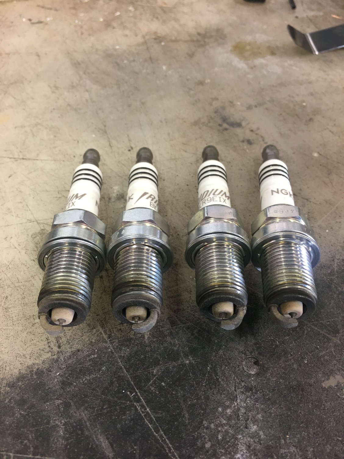

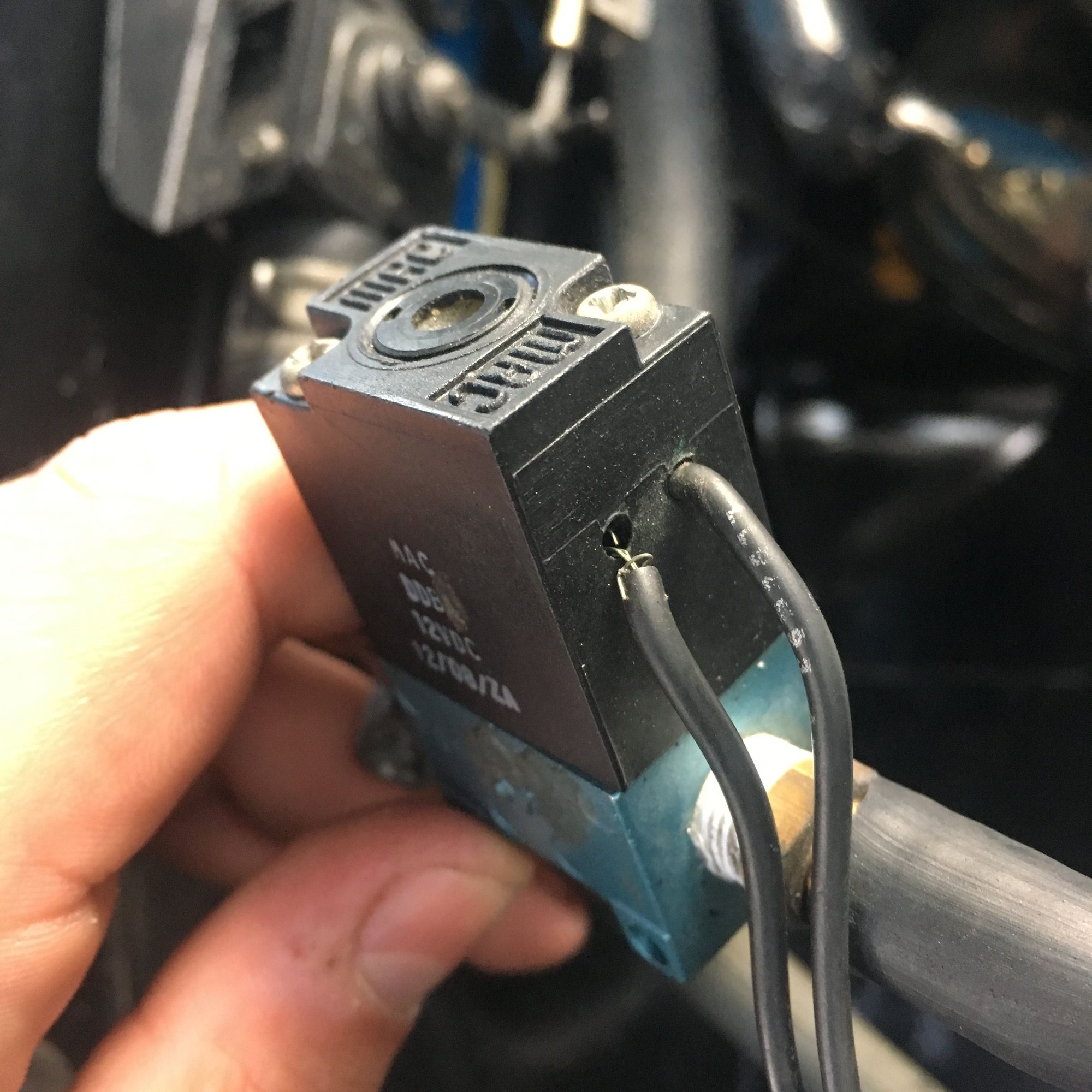

Car suddenly started hitting what seemed to be a 2 step at 6600rpm every time I hit boost back firing and not passing 6600rpm. Took a look under hood hondata boost controller one wire was about to break off. Replaced with a Mac 3 port (the same exact thing). Took it for a spin with same results. Plugs were perfectly fine iridium br9’s gapped at .019. Replaced anyway. Same results. Noticed if out of boost and close to 6600 rpm it would just bounce rpm at 6600 like you’re at the rev limit but very slowly and not go any higher.

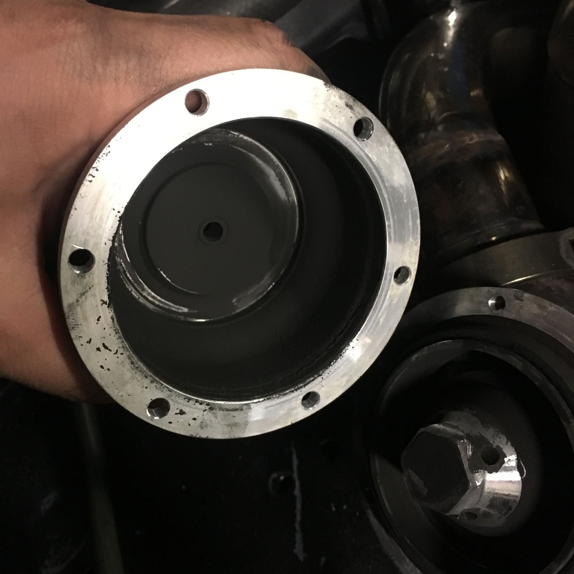

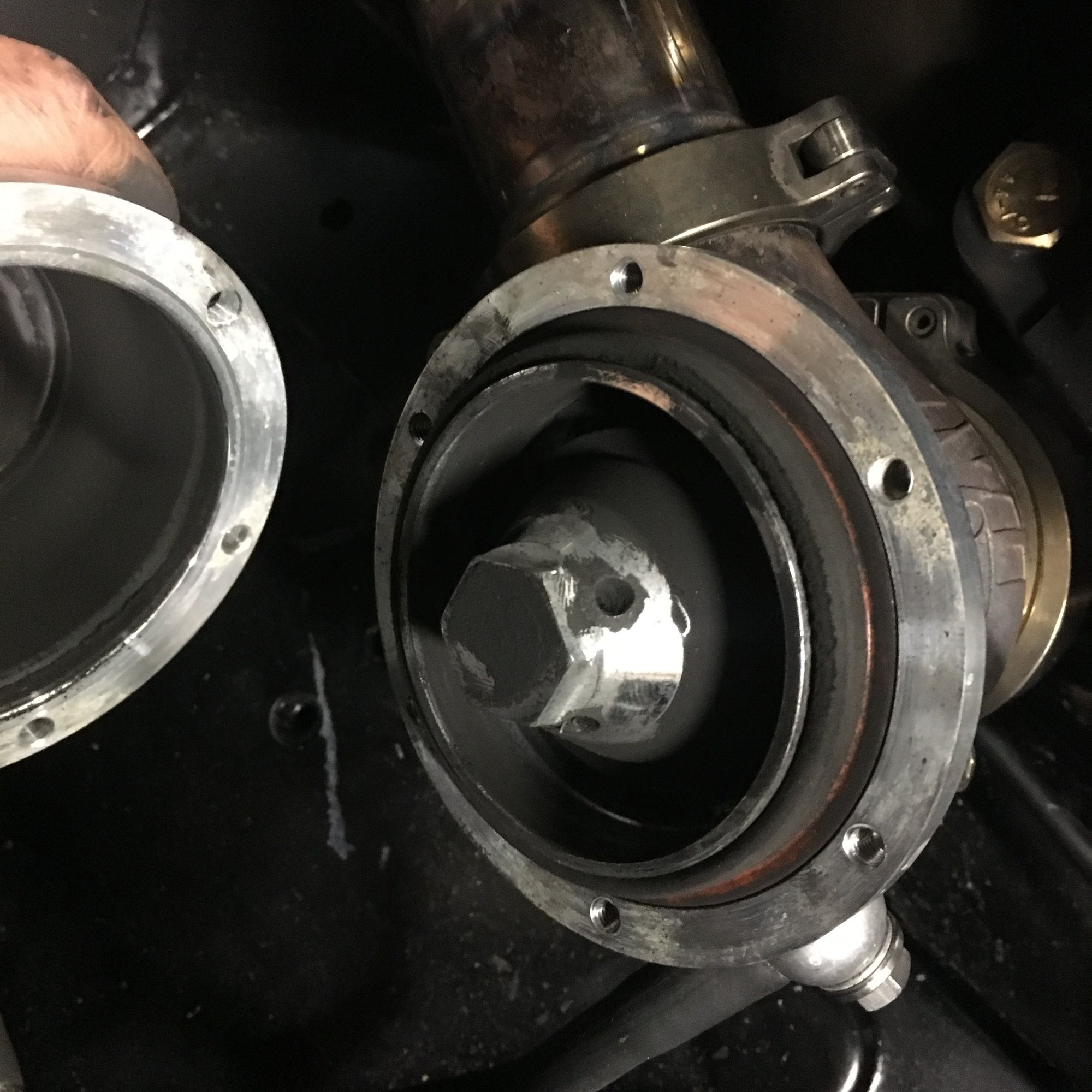

All vac lines seem ok wastegate had black soot in the spring area. Cleaned and check function seemed “ok” diaphragm def had wear. (From previous turbo kit tial v44) disconnected boost controller and car made 10psi off spring but wouldn’t pass 6600rpm again.

Sounds like boost cutoff to me. Misses are slightly more subtle whereas b. cutoff is violent like a 2step.
If youre breaking up up top you can lower the gap a little more. When you say br9 are you referring to these: BKR8EIX? If you have an 8 cold rating plug you can gap them down to 0.017.

Dude thats a lot of soot in there, r u running really rich? Anyway, sidenote you should be running at least one step colder 8 plugs, not 9.
And get a new solenoid if im reading your thread correctly. That doesnt look salvageable.
I replaced the boost solenoid already. not running rich at all, that wastegate is old and from the previous setup that was on the car. I cleaned it all out and the diaphragm looks worn but no rips or tears. I’m gonna check my vac lines as they are close to manifold and have a plastic Tee in the line going to the boost cutout and the wg and boost controller possibly it could have melted on the inside causing my issues.
as for plugs im using BKR9XI. You’re suggesting to go one step hotter back to an 8. I figured at my boost levels I should be 2 steps colder.
im sorry, i misunderstood you. Heat range 8 or 9 should be okay. I dont think thats the problem tho. Most likely youre overboosting. Definitely double check all your boost/vacuum lines. Especially the ones coming off your wastegate or nearest the manifold. My vibrant plastic pushlock fittings and polyethylene tubing all melted, also my buddys evo10 plastic tubing also melted on the dyno today. Replace them with regular barb fittings and heat resistant rubber hoses.
