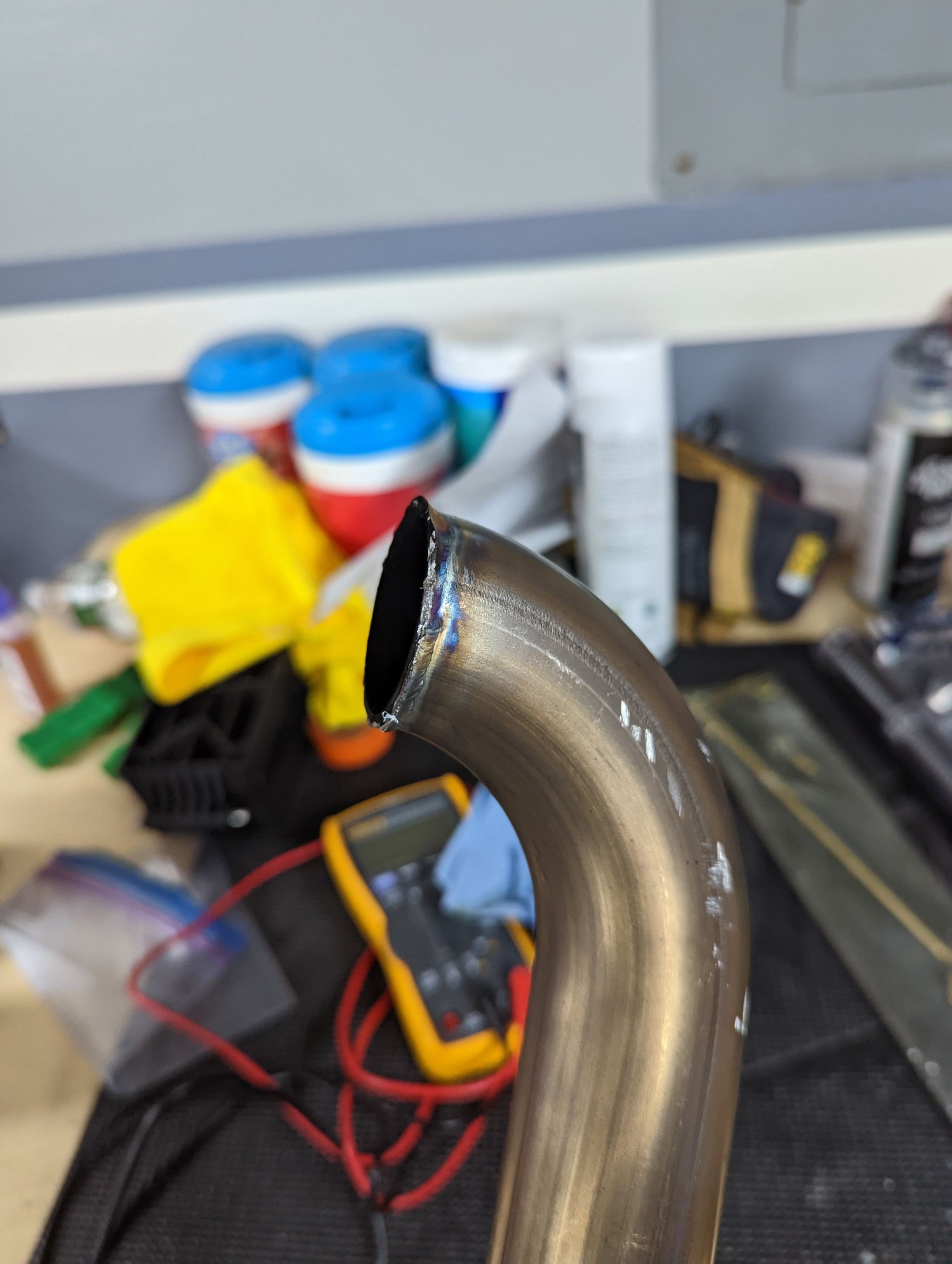

Originally Posted by Nivlac978
My dump tube broke off today on an off ramp. It broke right at the flange. That was a pretty long walk back to find it. Once I get the car in the air again I'll post pictures. I assumed the vband had failed but once I found the pipe it had snapped off at the flange. I assume the clamp is still on there. I haven't contacted ptuning yet. I'm gonna wait till I get under there and see what happened.

Originally Posted by treimche
Was your dump tube contacting the down pipe, or the frame rail at all? Either could cause it to crack.
Once you have a nice quality weld on it, make sure there's wiggle room so the dump tube isn't touching anything and it will be fine. There's no need for bracing, the thing hardly weighs anything at all. The issue is either the dump tube contacting something, or a shitty weld.
There was a good amount of space in there for it. It wasn't touching anything. I should have time today to get the car in the air. I'll post some pictures. I don't know what a bad weld looks like, hopefully someone can tell by the pics.
Old Sep 27, 2022 | 06:23 AM
  #135
Nivlac978's Avatar
Joined: Oct 2017
Posts: 92
Likes: 11
Old Sep 27, 2022 | 06:55 AM
  #136
Kyle's Avatar
Joined: Jun 2018
Posts: 2,116
Likes: 671
From: Connecticut :(
Penetration; where art thou?
Old Sep 27, 2022 | 07:22 AM
  #137
Nivlac978's Avatar
Joined: Oct 2017
Posts: 92
Likes: 11
I assume that means bad weld. I'll shoot em an email. I would like to get a couple more months of driving before it goes away for the winter.
