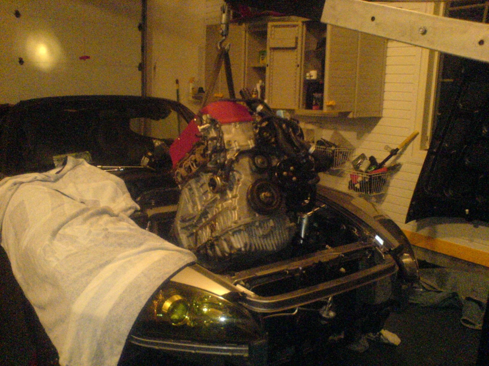

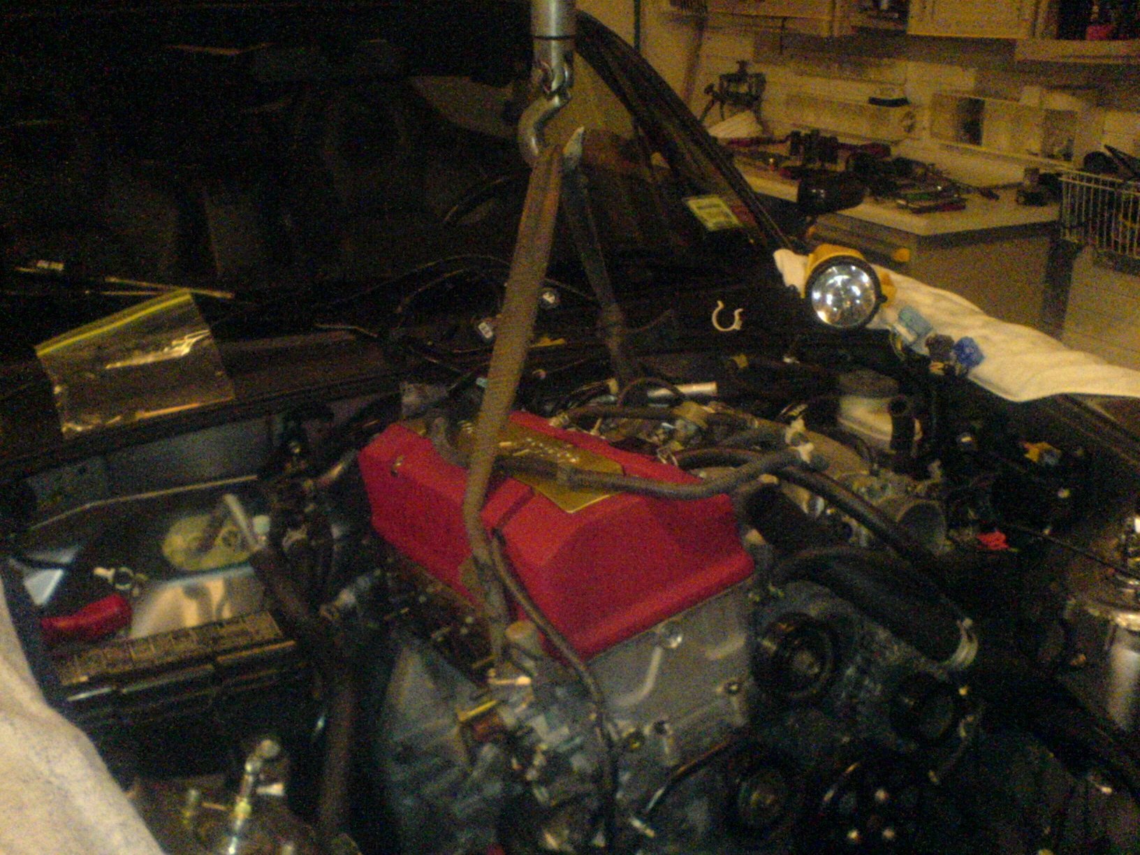

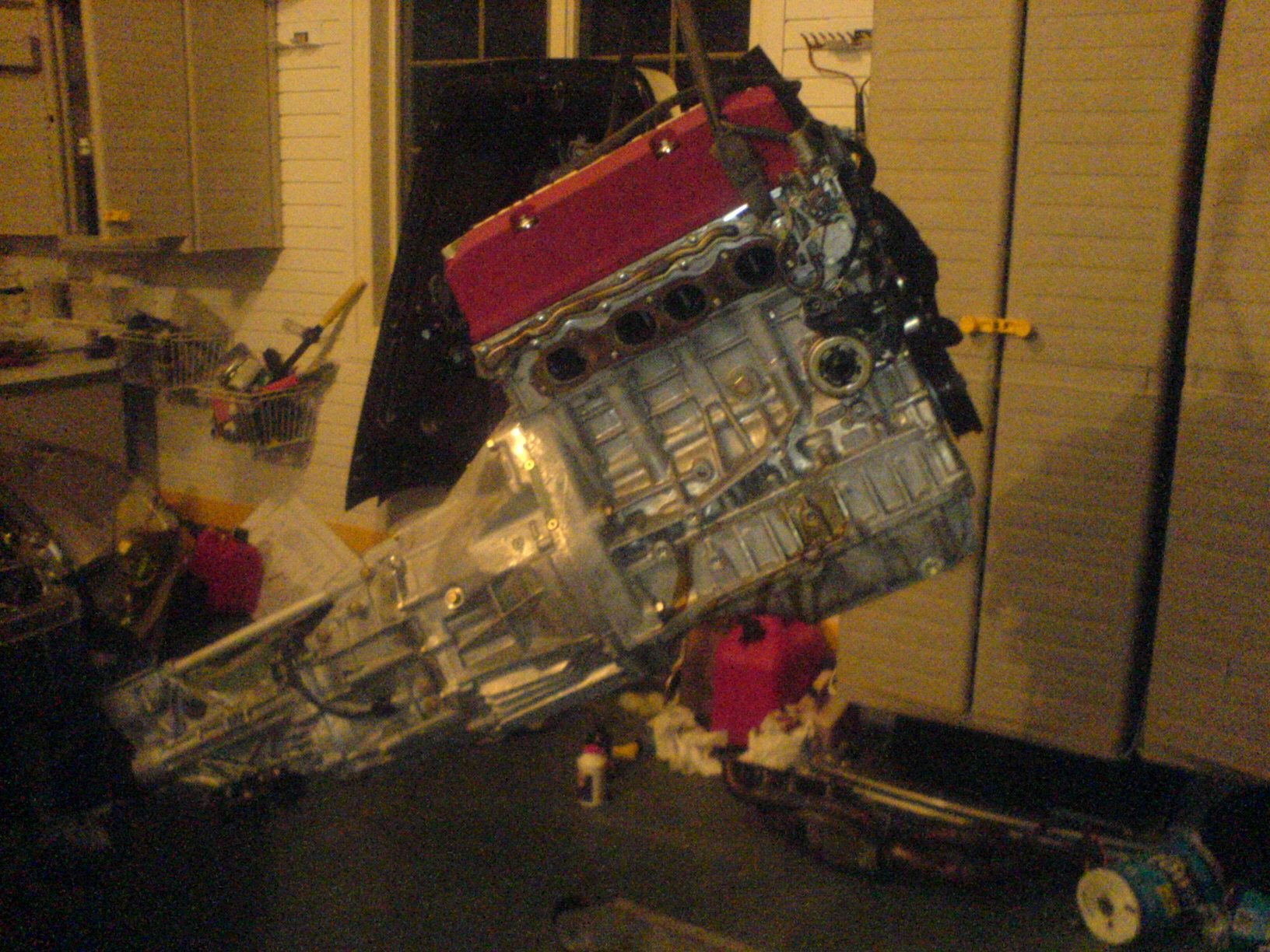

i want pics!

haha, you'll have to wait til i blow it up again
