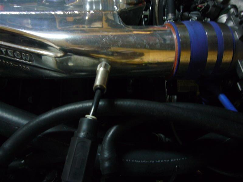

Here is how I did mine, and it seems to work fine.
I cut out a portion of the Spare/Tool Kit to fit it like this:
The check valve close to nozzle:
And the Controller under the dash, left side of wheel:

Super clean, very nice
